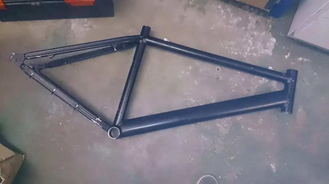

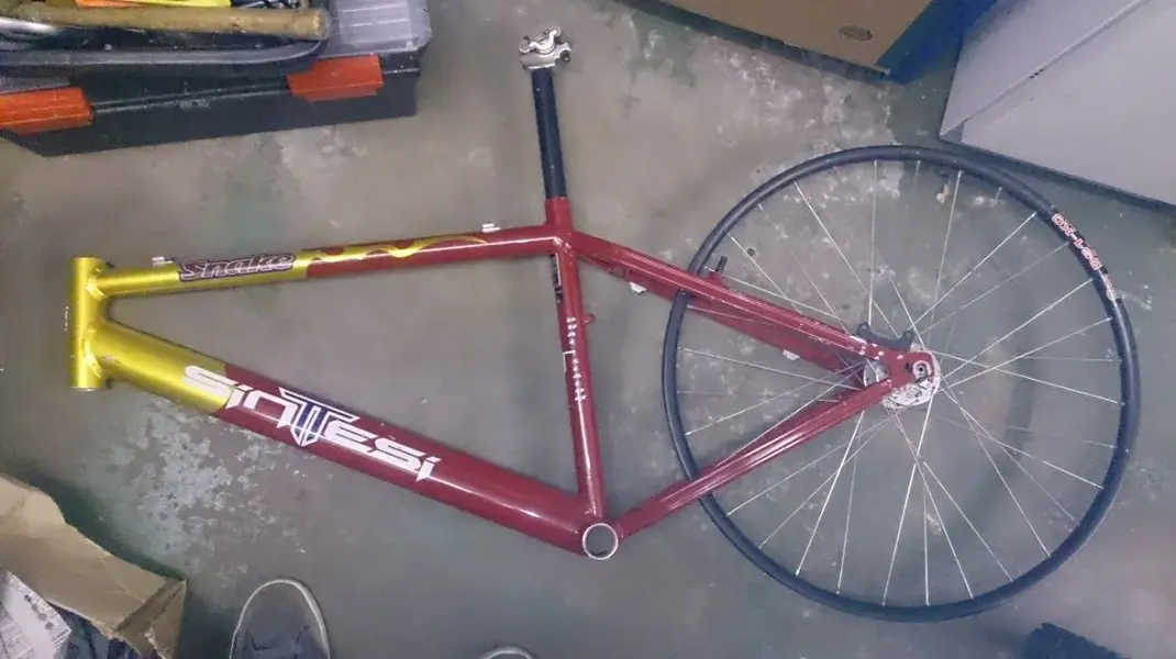

As well as the Arrow DSS I have on the go I have my Sintesi Snake.
I loved these when they came out and thought the paint job was absolutely awesome so when I saw one come up for sale a few years ago I had to have it.

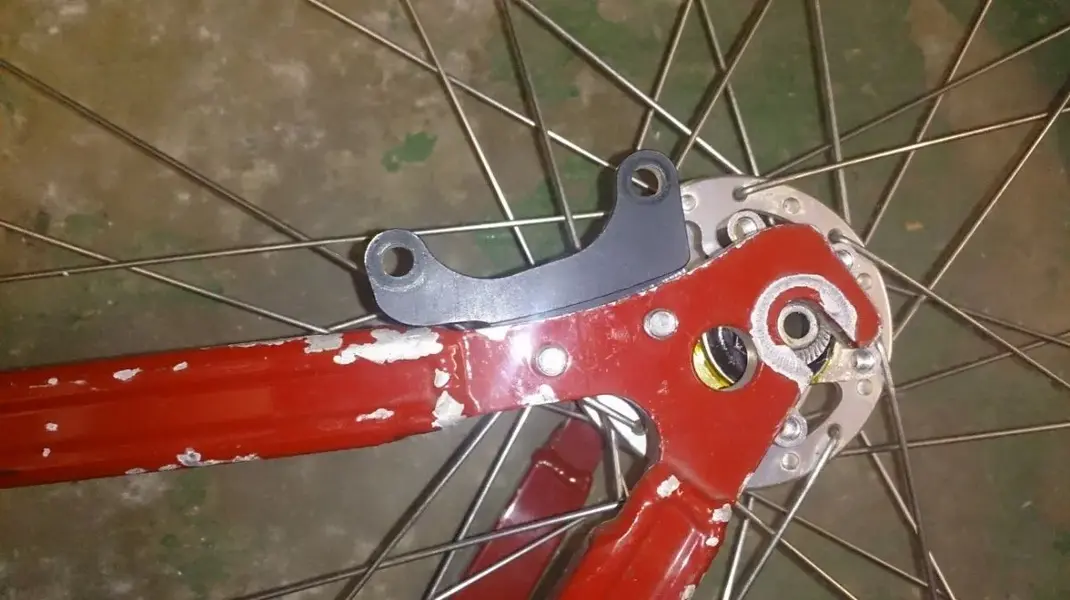

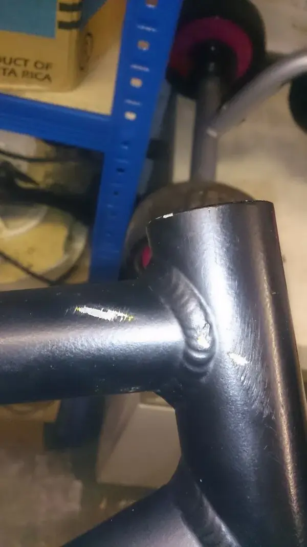

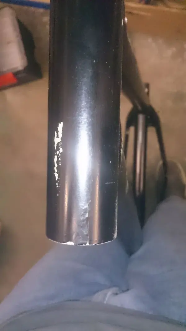

I hadn't built it as I wanted to run discs on it but the adapter you need is rare as hens teeth. A few months back I saw a Sintesi frame on eBay that had the adapter, it also came with seat post, headset and forks. Annoyingly the frame has been mutilated as it had been spayed black, brake bosses cut off and the front mech cable stop ground off. I also found 2 cracks in the head tube when removing the headset. The Forks were Marzocchi Z1 MCR and the cartridges in both legs are knackered and the parts for these are non existent so won't be using them. The headset is an FSA Orbit XL and seems serviceable so will probably use it. It seems a waste to bin the knackered frame so might sandblast it and polish it to turn it into wall art. The Mrs would hate it!
Also wondering whether I should try patch up the paintwork on the good frame.
Anyway here's some pics of the frame.

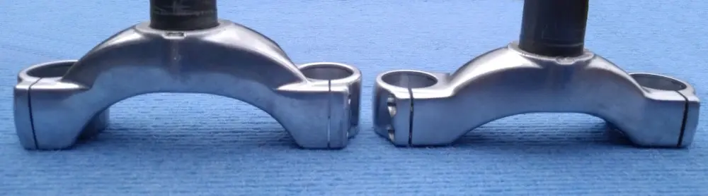

Z1 crown removed, it's at this point I noticed the Z1 and Z2 crowns are different. The Z2 crown is flatter on top and not quite as much support for the stantions. At some point in the future I may swap the steerer if I find someone with a press, but for now I'll swap the crowns as planned.
No, that crowns are the same if the forks are from the same years, but with Z1 BAM + Z2 BAM Marzocchi changed the crown height because of weight reduction and opticals. They also changed the top caps (5), the cartridges head (11, top part and thread direction changes), 7 and the knobs.
Exchanging steerers is easy with the press and the correct tools. Drop me a note if you need some help in parts or steerer exchange.
