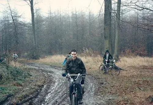

Sit Up and Beg
Any more sit up and beg than a Cleland and it's called a recumbent.
The problem is that Cleland Cycles ltd went out of business in 1984 and so they are very rare and seldom come up for sale.
This links to a page about the Geoff Apps designed Clelands.
http://clelandcycles.wordpress.com/bikes-1978-2010/
There were other Cleland style designs made by English Cycles and Highpath Engineering, but these are even rarer.
I am 6'2" and have enjoyed riding Cleland style bikes since 1984. Unlike the Schwinn, the Clelands' frame geometry is modern except for the shorter top-tube and slightly higher bottom bracket.
There has been talk for a while now, of Cleland style bikes being re-produced by Brant Richards of Shedfire fame. If this does happen I suspect that riders with neck, back, wrist problems etc would very interested. These bikes are not only comfortable but very capable especially when fitted with top quality modern tyres.

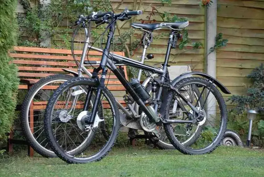

velomaniac":3e6rx9dq said:
Highpath would be great if cash was no object :lol:
*Not a Highpath
*Not Retro
*Not Expensive
*not pretty
But geometrically very similar to the Highpath behind.
This Highpath impersonator is based on an medium (18.5") 2005 Giant NRS with a long vertical (though adjustable stem) and an 450mm seat post. (I have a 35" inside leg measurement)
And the NRS Has a similarly high bottom bracket when the suspension is run with no sag.
The Highpath has the advantage that its 650b wheels can be run with big, high air volume tyres and still have loads of mud clearance. The NRS has smaller 26" wheels though its suspension gives it the advantage on technical climbs and rough downhills.
A small framed (16.5") is an even better geometrical match though even with a 450mm seat pin it would probably not be high enough.

Bloody hell m8 :shock: are you sure thats safe to ride on :?
Im a 34" leg and i think thats over done.Whats the frame size ?
