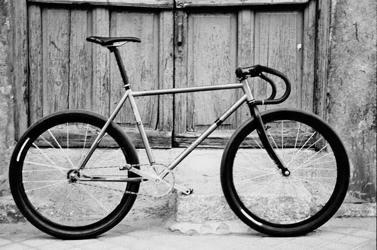

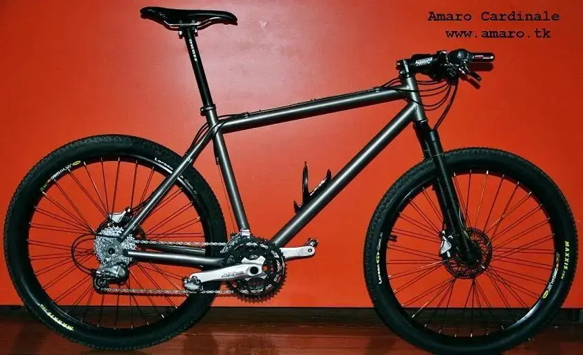

Yes the supermotard is cool. Here a supermotard ss and a MTB.
Really I prefer to buy a Merlin XLM or a Moots and then put some cheap hardware (amaro or ather) The frame is the sould of the bike, but the amarao cardinale could be as a good choice as an Airborne for example. The welds are similar.
