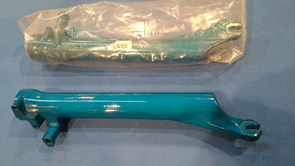

Somebody know this Bomber Tube Type?
Dr-Zocchi
Don't know which modell :cry: :cry:
Thanks!

Maybe Z1?
Re: Re:
kraeMit":254awklm said:
Hm. As my one is a left tube: the disc brake adapters are missing. :? :?:
Thanks!
oops, didn't spot that. :oops: them Z1 forks had adapter on both sides for twin disc brakes.
it's only a Z2 is you look inside and it has the "swiss cheese" bushings
it can't be a Z1 as it's missing the disc tabs, which were instead of the 51mm standard a rather odd 47,5mm spacing
but I think it's a '97/'98 Z3 Light or a Z4 as discussed few years ago. colour would indicate this
Why would there be a bushing in there?
FluffyChicken":1d9pqc77 said:
In the legs? Usually lowers come with factory installed bushings.
