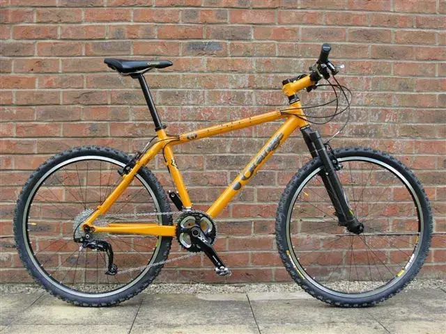

I'm new to this forum gubbins so I've attempted to add a pic of my E4 but probably done it completely wrong!?!
E4 serial number to follow...
My E4 and AirO are my current regular rides - it's more of a 'retro flavour' bike than a true retro build - opted for rigid and V-brakes over bouncy and discs to keep the weight down and maintain simplicity for big rides on the Yorkshire Moors and Cleveland Hills. My AirO is my 'fat fun' bike - for bouncing around in the forest :P

Decent 99 E4 you've got there! So I've still got the only 98 E4 on this site, unless somebody else has one to show.
How can you tell it's a 99 frame from the pic? Did 98s have a canti bridge or something similar?

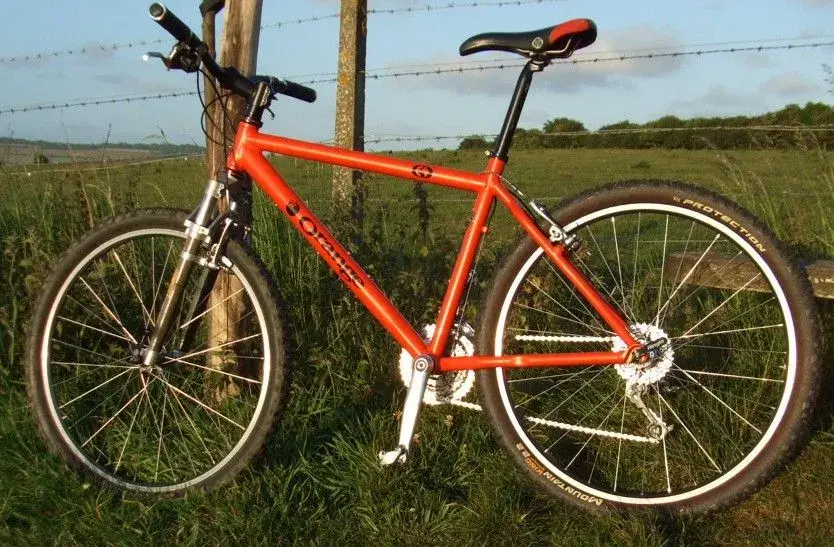

See below - the 98 was a red-orange colour, 99 yellow-orange, 98 had a single cowl over the dropout, 99 double (allowing for different design of mech hanger) and you can also see from this picture that the 98 frame had a mount for an E-fit front mech, and I'm not sure whether they kept that for 99 and 2000.
