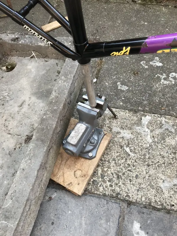

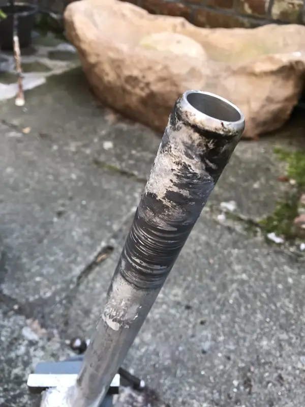

Good day to all those who have had to fight the seized seatpost battle. Well I started the strip down of my Specialized Stumpjumper Epic as I have completed all my house chores👍👍 most things coming apart easily except for that seat post. 2 weeks of fighting, temp treatments, you name it!! After conceding to the loss of the post, the bench vice was next. The challenge here is it is too high to really get any upward leverage. So as you can see from the photos, I conjured up a plan to floor mount it. But after shifting the wife around the room I resorted to using good old masonry work! Oh an yes a dirt cheap multi spray which for some reason after a night of sitting in the upside down tube I managed to get it to turn a fraction using a plumbers wrench and an extension bar. It took another week of repeated cheap multi spray and the wrench, and lots of sweat I moved over to the floor vice. Well it took about 1hr of backbreaking heaving and repeated spraying and out she popped😁 Now the fun begins!!

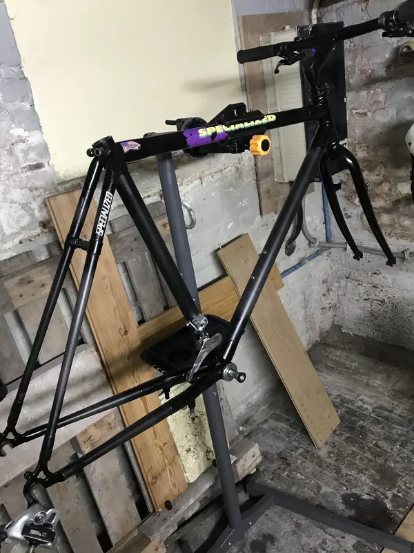

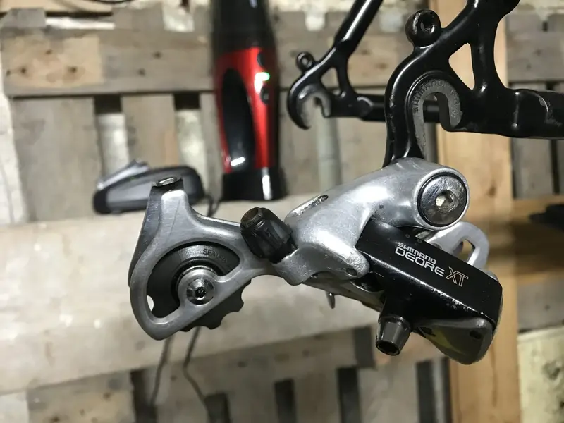

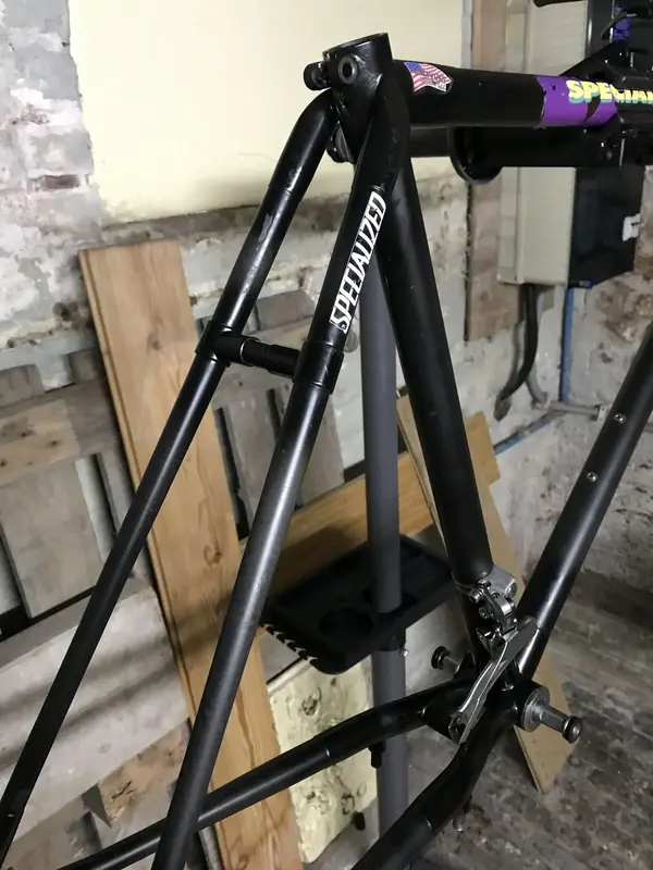

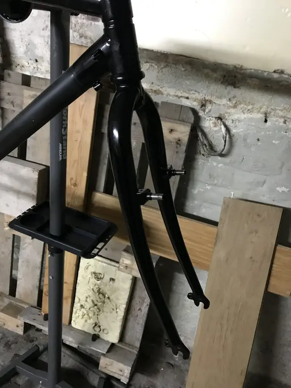

Here are a few pics of the cleaned frame. Sorry they taken inside. Added a cleaned up XT rear derailleur to replace the STX. Cleaned the XT front. And after a bit of elbow grease and buffing the forks and frame cleaned up nicely. BB regreased and for now thinking of using a set of crank tension bolts with dust grommets (not sure of the tech term). These will complement the CQP M2000 cranks which came with the bike but were missing dust covers. Need to source a replacement seat post still. Not sure on the Deore hubs with the WTB dual duty XC rims. To replace or not too? I have a set of LX hubs on Specialized Z21 rims but not sure which would be a better fit. Any opinions or suggestions welcomed?? Thx
