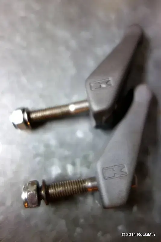

yep kona did a fork mounted canti hanger for P2s. But they're a bit of a pig to get hold of. I have something similar in silver that I'm not using that you can have for free if you give me your address. Will fit P2s.
If Ken doesn't go for this I'd be very grateful for it please! :D
Godwin-Austen,many thanks for the offer but I think I'm going to look for a pair of bar ends, they should give me a few more options for moving my hands around, elpedro666 I'm sure could make better use of the hanger than me.
