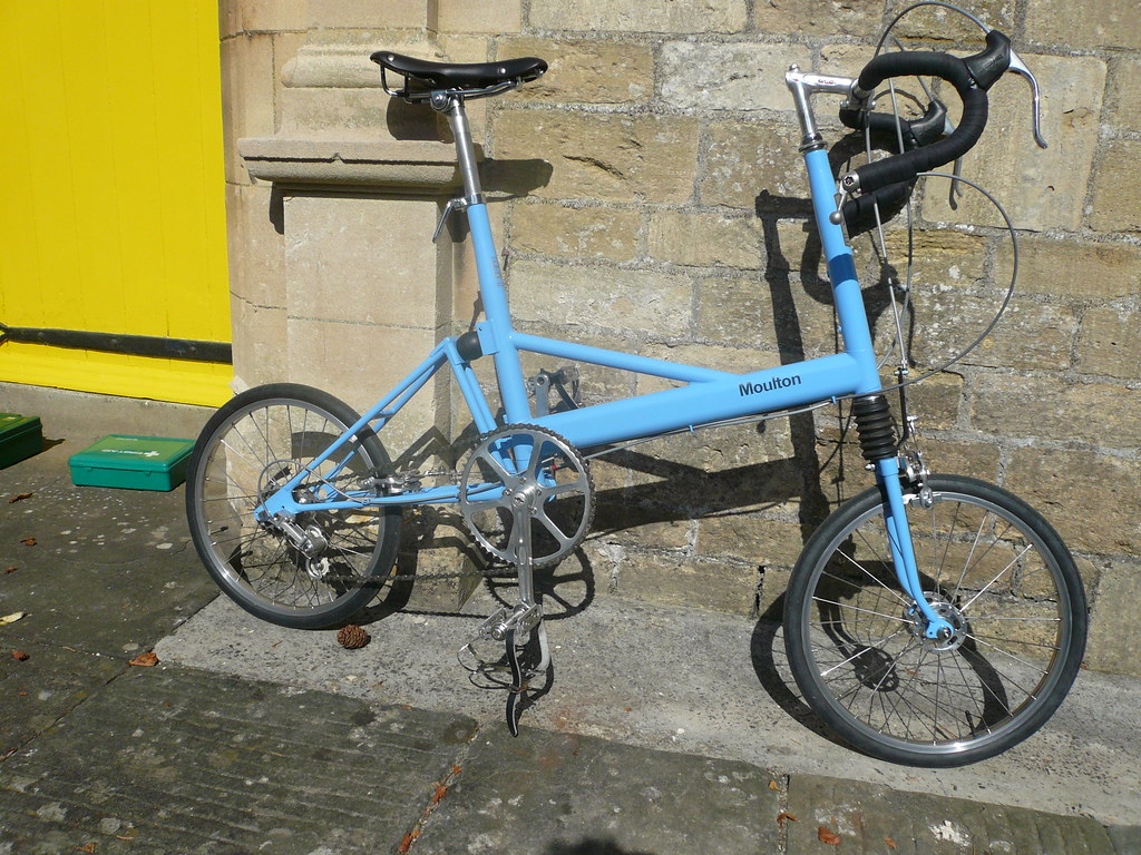

One of my old (now sold) Mk3's, you can see how the drum brake was held.
Re: Sturmey Archer Questions.
That looks in much better condition than mine! I say "mine" but my mum and dad visited us last weekend and she sort of decided the bike would make a fine birthday present for her! To be fair I don't think it would be big/strong enough for me so an ideal solution!
Seeing your bike there with its stand. Where did the stand attach to the frame? There is a piece of metal welded to the rear triangle that I assumed would have once held the stand whereas yours looks to be on the main frame? Is that an after market stand?
That was (still is) in near perfect original condition. Not bad for a bike that is about 40 years old! And that is another thing, they are pretty robust but can have age related issues, the front suspension bushes can wear which will play havoc with the steering as well as make it feel as if the races are not adjusted properly, the rear suspension 'ball' is unavailable so don't break it! The bottom bracket is that odd Raleigh 26tpi thread horror so don't think you can chuck a sealed cartridge in there, they don't exist (well they do but Phil Wood costs a bomb!) but there are a number of bodges that might work.
But they can make the basis of fantastic specials (not mine, sadly)
Should be on bottom bracket. It is exactly the same as the one on the Chopper (and probably many more bikes of the 70's). Good luck finding the bits. :wink:
