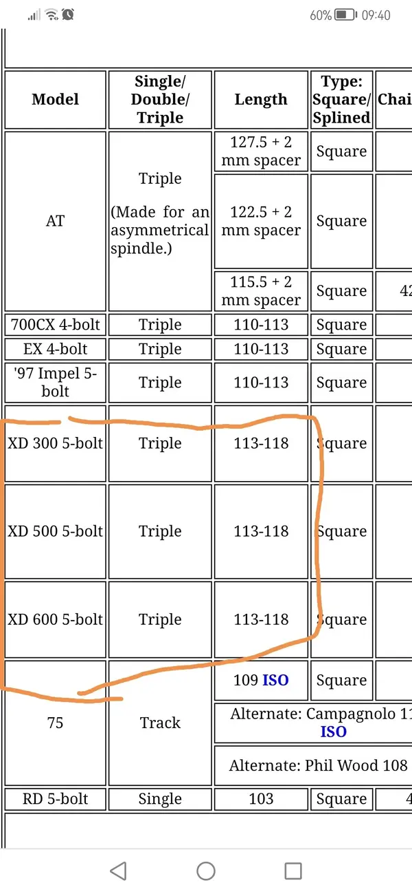

I'm going to be using a Sugino Mighty 900 chainset on my Explosif but have no idea what axle length is required for the bottom bracket, anyone know the correct size 🤷‍♂️
The mighty 900 isn't on but the ones i've highlighted are all between 113-118 so i'll guess that the 900 should be the same then

113 should be the sweet spot. Anything more and it starts getting a bit sketchy.
I run 113 or 110 on mine, both are fine although I would go for 113 if there is more than 10T difference between middle and outer rings.
Good choice - lighter than XTR and every bit as well finished.

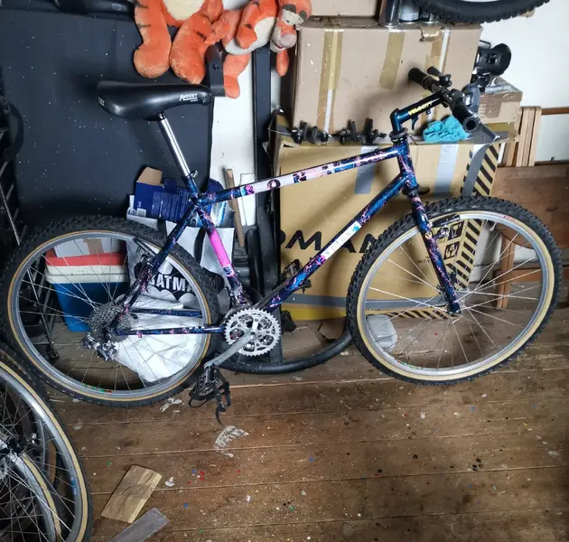

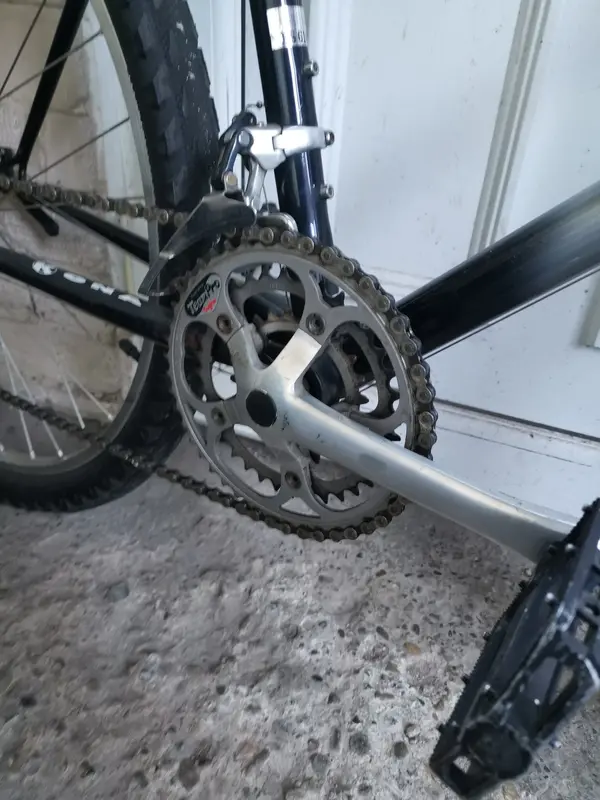

Cheers for all the advice, another thing came into my head because i'm currently looking at the other 93 Explosif which is all standard so has a 8 speed set up. The other one will be running a Deore XT 7 speed hub so 7 speed cassette, will that make a difference on the axle length needed on the mighty 900.
Not really, in theory it should be a couple of mm closer in, which would favour the 110 slightly. In reality is the frame exactly true???
