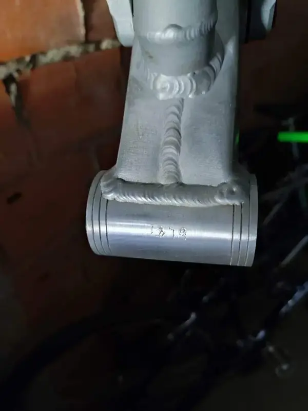

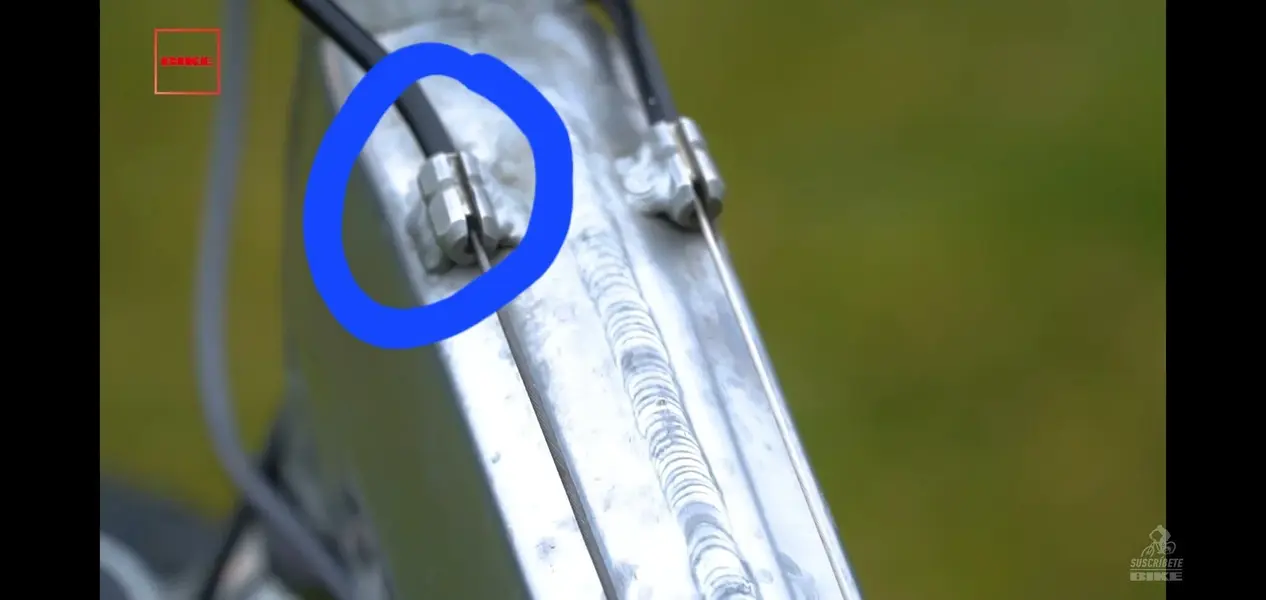

I just bought an early version of MC San Andreas and I'm trying to figure out what year it is. The seller claimed it was a 92 model but I quickly realized it wasn't! He said that he was in contact with Mike Bulen, who welded them, and even he confirmed to me that Mike Bulen thinks it is really a 92. Of course, there's a chance Mike doesn't remember all the frames he welded nearly thirty years ago. On the MC facebook group, a guy with a lot of knowledge and I found out that it is most likely a 94. Because the 92 and 93 had hexagonal cable stops, but mine has oval ones. But I don't know if that's 100% true given that welder Mike Bulen didn't mention it. However, after looking at hundreds of images from google, it looks like this claim will hold and they only added ovals cable stops in 94 and before that they used hexagonal ones.

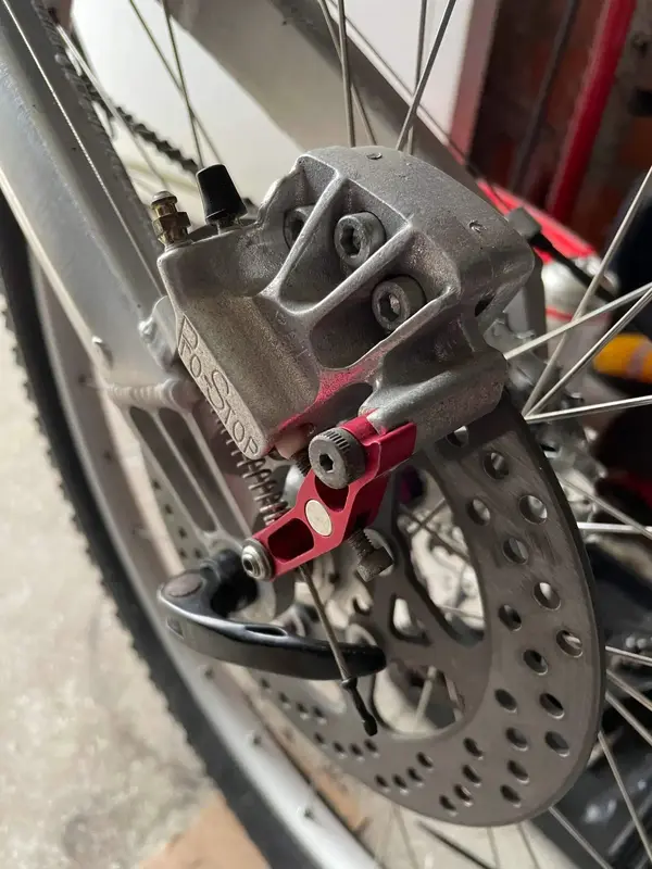

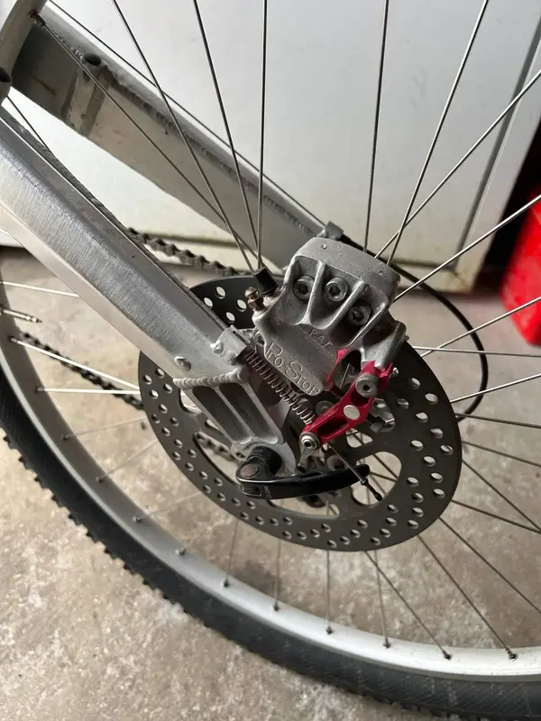

But we were confused by the 4 digit serial number which indicated that it was seriously possible an earlier model as mine has S/N 1379. But now I found this article where you mention that they reintroduced the 4 digit frame numbering in 94 . It's build with the Suspenders system 3 fork which also hints on 94 model. I also found an ad where this fork was offered in Cobalt Gray and Aluminum look. Mine is an aluminum look and I thought someone had de-anodized it because I haven't seen it in an aluminum color until now, probably they werw rare in alu color. The Noleen shock absorber was replaced, was originally on the frame After Shock with elastomers, that what he claims. I'm not a fan of the 94 sticker graphics myself, but I like to bring back the stickers belonging to the frames from right period. Therefore, I would like to ask you to help me find out which model from 94 we are talking about? You mention the R-series 8.6, which was the only one that had Suspenders and ProStop brakes, and that could have been it. The only doubt that gives me is that you mention that it was with a matchin tower and fork ("R8.6" frame, suspenders, prostops f&r, matching ano seat tower."), I assume you talk about an anodized cobalt gray color. Mine is all silver,..frame, fork and seattower. Of course, there is also the possibility that someone bought a Suspender fork and Pro Stop brakes afterwards and custom build it. I've always wanted to add an early San An to my collection, let's say a 92, but I don't mind if it's a 94 because it's important to me that it has the Suspenders and Pro Stop brakes that are iconic for my classic bike collection taste.
The last two pics are from 92 bike just to show the hexagonal cable stops.
