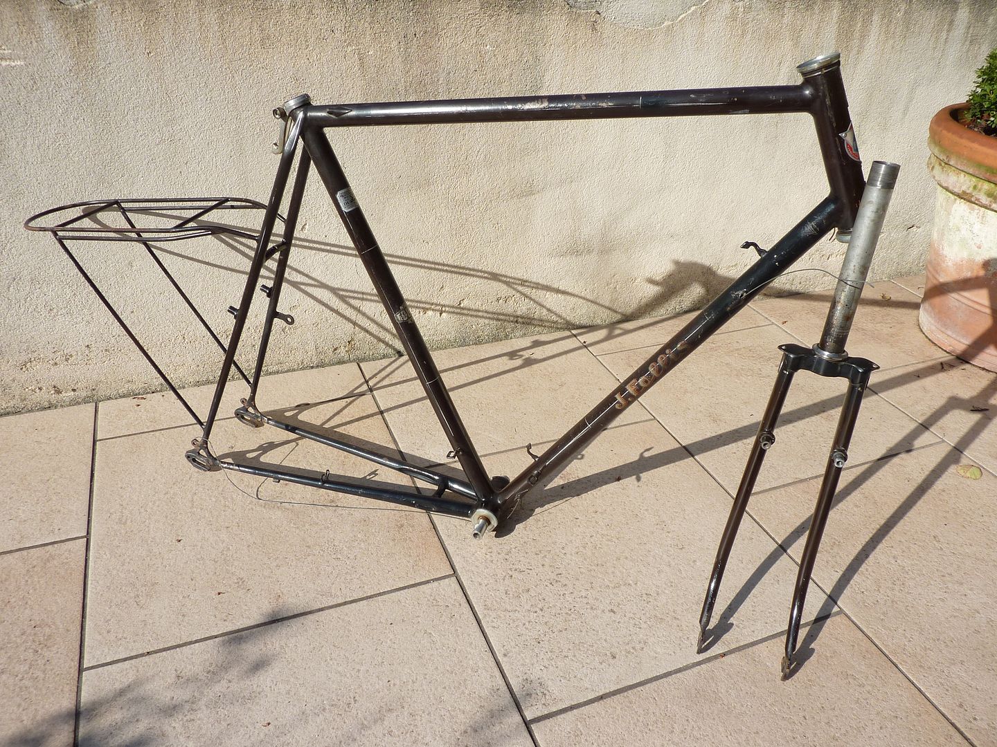

Not in the same line, but to illustrate the Follis mention I happen to have a 1940's Follis frame but of a "city bike" - very nice filet brazed frame in Durifort Serie C Extra Legere with internal cabling and brazed rear carrier.
Unfortunately, end of stays was modified in the 70's and cyclo derailleur hanger suppressed :evil:
Still don't know what to do with it as trying to restore it to its previous state is very difficult because the stays were shortened :roll:
This is a Follis of the interesting "Follis" era I would say

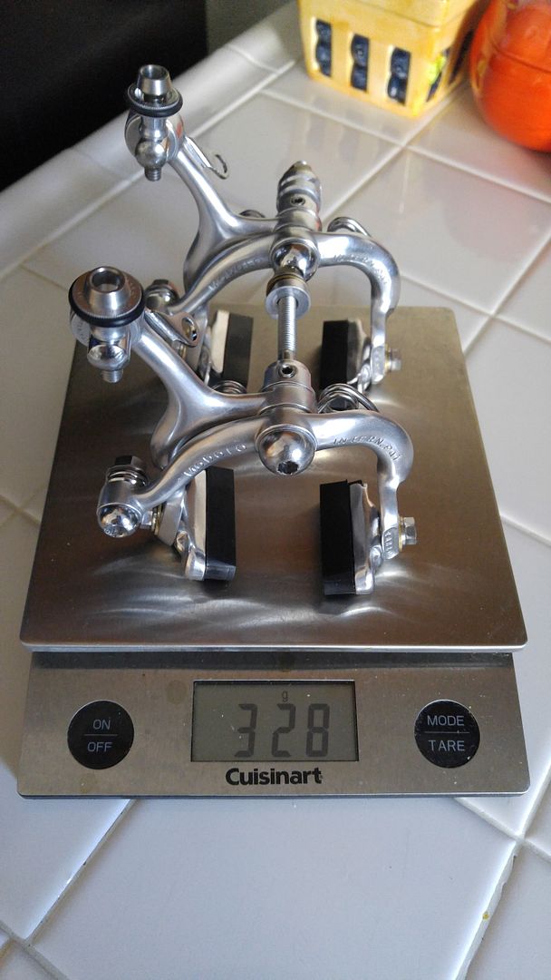

The Modolo Professional brakes are very nicely made, a bit heavy compared to the top line CLB's. I don't have a weight for the stock calipers, this set has the brake shoe bolts, all the 6mm nuts, and the cable adjuster screws replaced with titanium. The shoe inserts are black compound Kool-Stop and the wire guides for the tires were removed.
The brake set as configured weighs in at... 328 grams 8) , on VeloBase one of the commenters had this to say about weight...

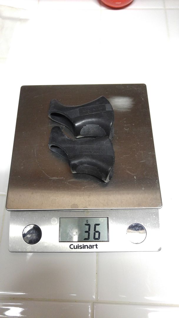

The measured weight for my calipers and levers was 570 grams without hoods, I just now weighed the hoods at 36 grams for the pair, so the corrected weight for my stock brake set with levers and hoods would be 606 grams so "jakeH" was right on with his total weight of 609 grams. the weight differential is within 0.25% of each other :shock: .
I can't believe the few changes I made to the calipers removed 72 grams, I also can't believe I stripped, polished, and installed a bent brake arm on the front caliper :facepalm: . fortunately its not the side with the serial number on it, I have a perfect spare as I built this brake set out of the best parts of two brake sets, I have a lot of spares :D , that's tomorrow's project.

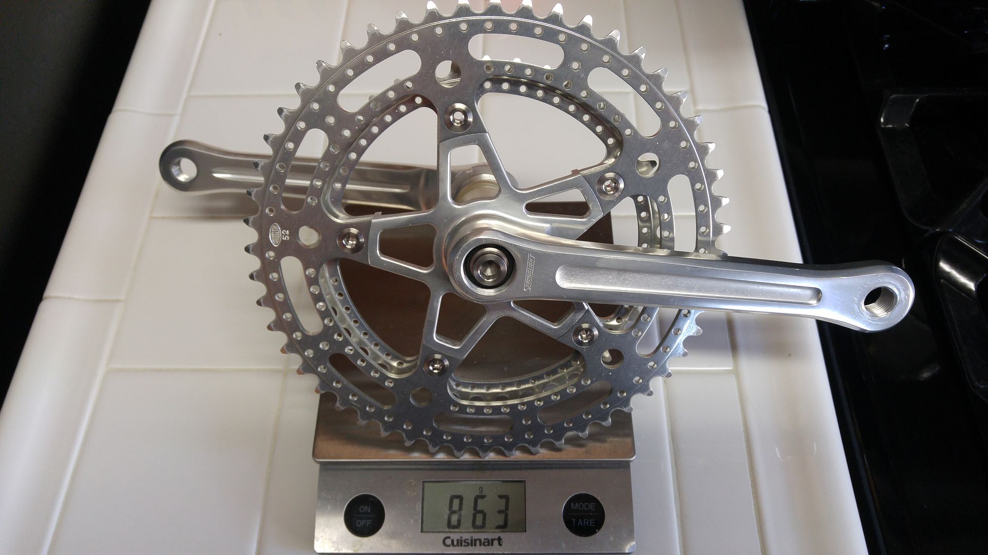

The last version of the Stronglight 105 BIS with the standard bottom bracket has a manufacturer claimed weight of 908 grams.
With the Stronglight Competition 651 (hollow steel axle, sealed bearing, alloy cups) bottom bracket, and titanium hardware my 105 BIS weighs in at 863 grams complete.
This is not bad for a crankset with all the hardware, however I'm still looking for a Stronglight Competition 650 titanium 118mm axle or bottom bracket which would put the assembly weight at about 815 grams, but that might be a price to far for a 48 gram weight loss.
For comparison a Campagnolo Super Record crankset with a thin cup 112mm steel bottom bracket and bolts weighs in at 902 grams, with a Campy titanium bottom bracket the weight would be just over 800 grams. It is interesting that these competing cranksets are so close in weight in their stated configurations.

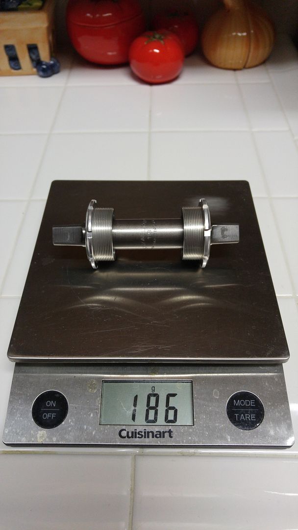

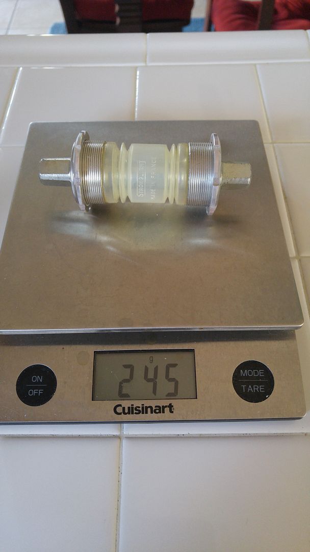

Stronglight spindle stuff... Well I found a model 650 titanium bottom bracket on ebay listed as being steel, I tried to be nice and asked the vendor if it was titanium, I got a one word response... "Steel". I bought it on the spot 8) .
The bottom bracket received was in wonderful condition with little use and indeed titanium, needing only a long soak in solvent to remove the old grease and a repack of the SKF bearings with CV extreme pressure grease, now it's smooth as butter. I replaced the received cups (somewhat chewed up) with the NOS cups from my model 651 bottom bracket and the result is as seen below (I removed the dust sleeve as it makes the bearings very hard to clean properly -3 grams).
This is the steel model 651 bottom bracket at 245 grams. 245g - 186g = 59 gram weight loss, so the total weight of the crankset is now... 804 grams.
But I'm still not happy... Next is a set of 7000 series aluminum crank bolts and mil spec aluminum washers that should trim 12 grams... This is a paradise for someone with OCD 8) .

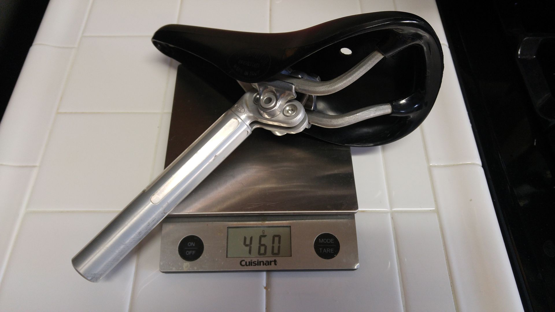

Next up is a Unicanitor SL Superleggera with the forged aluminum frame, mounted to a Sakae/Ringyo (SR) Extra Super Light seat pin with factory titanium hardware, total weight for the assembly... 460 grams.

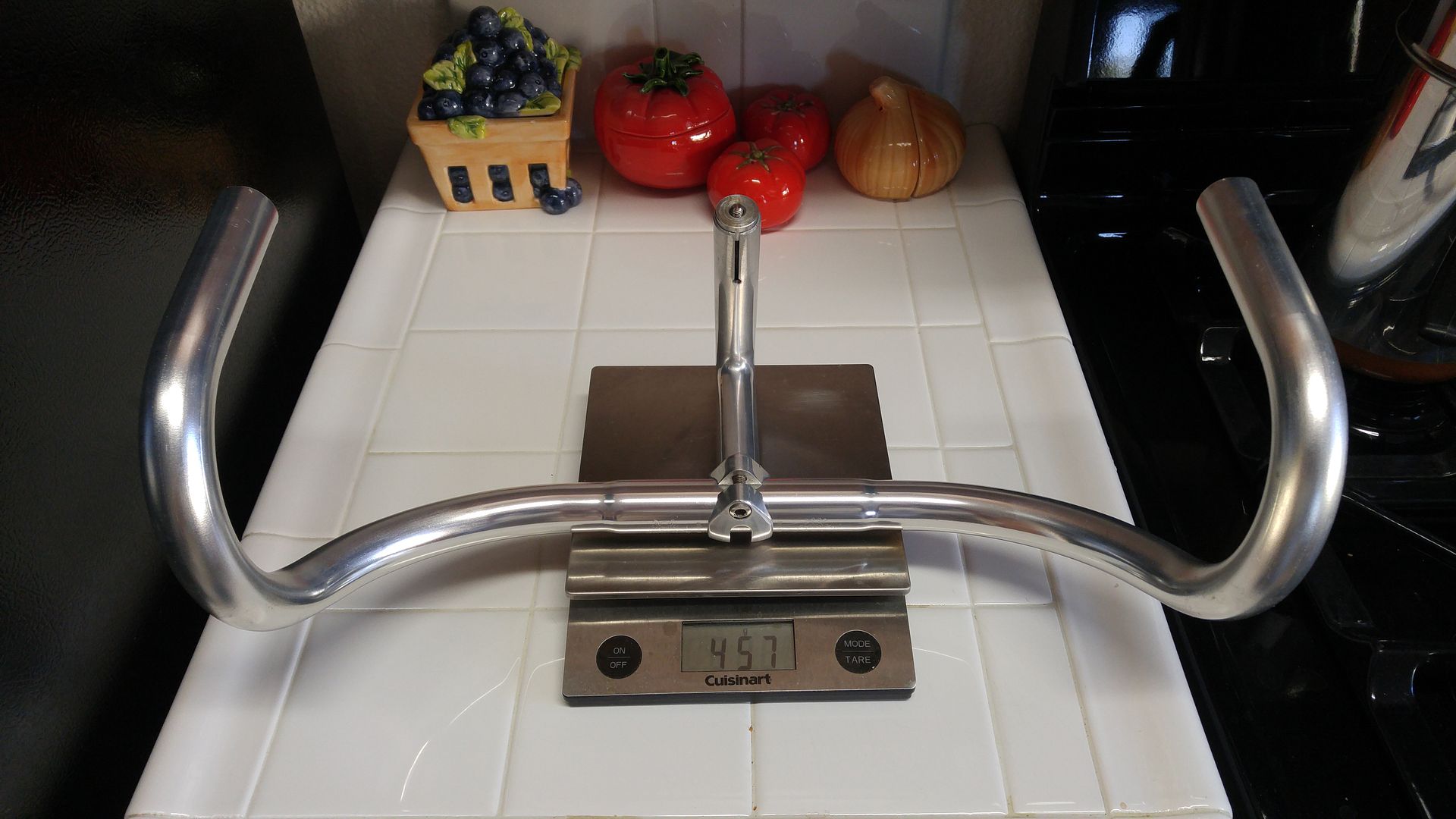

To round out the cockpit, 3TTT Superleggero 42cm Gimondi bend, hung from a Sakae/Ringyo (SR) Extra Super Light 110mm stem with factory titanium hardware, total weight for the assembly... 457 grams.
