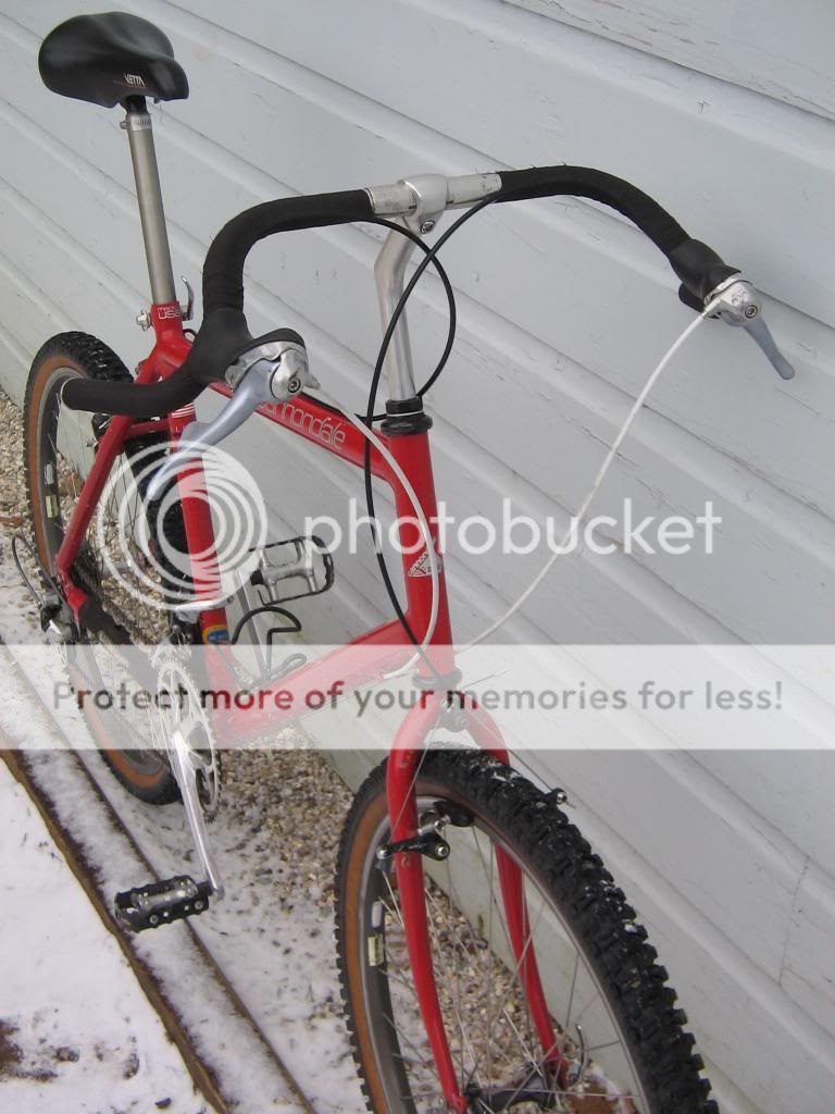

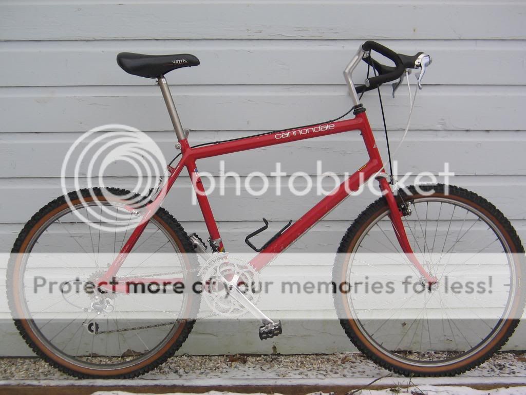

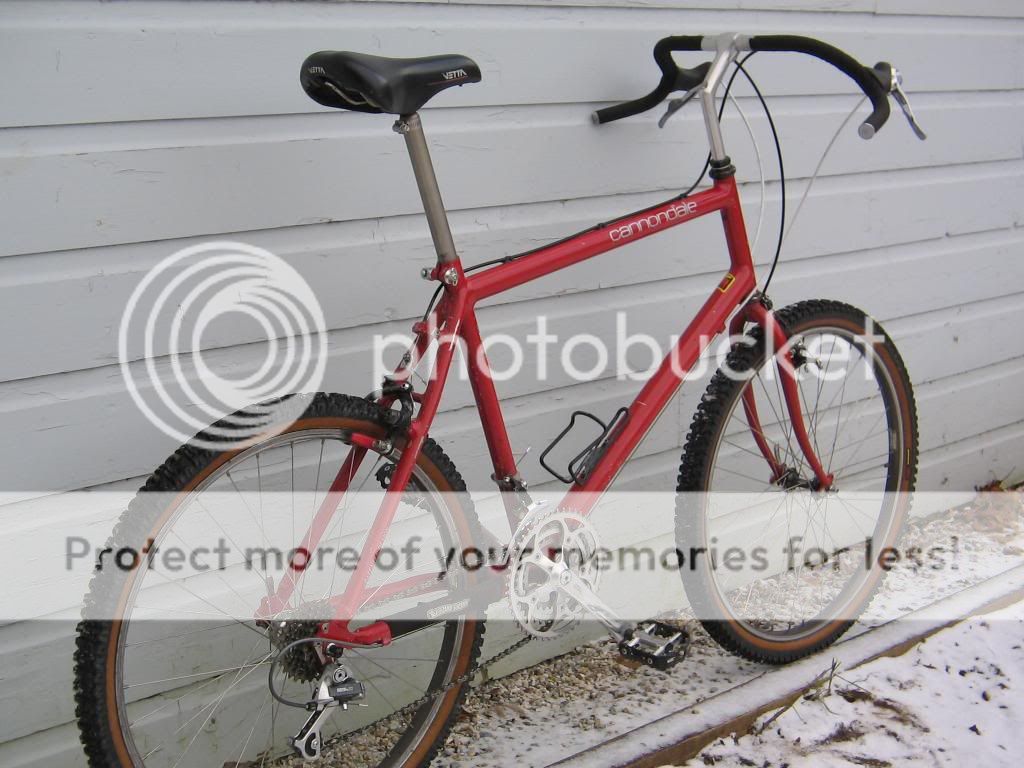

This is my drop build, 1988 Cannondale SM700. It's perfect! Unfortunately I've tried 3 MTB front mechs with the old RX100 brifters and nothing will shift all 3 rings. I was reading about compatibility issues a few pages ago in this thread, have done some googling on my own, and am still not sure if the problem is worn-out front mechs (all 3 have sloppy pivots) or incompatibility. I hate to dump coin on another front mech, but I'd love to shift the front with the lever as intended. I will update when I find a road triple, bottom pull, 31.8 clamp unit that's suitable.
That's very cool bike. Road shifters are not compatible with MTB front mechs. You will need road derraileur unfortunately.

You can use a MTB front mech with STI, but it requires a small modification to account for the
lower amount of cable pull from the STIs.
Cut a small groove on the arm of the FD the other side of the pinch bolt where the cable
normal attaches. Route the cable in the new slot, fasten up and away you go. It's good to have an
inline cable adjuster to help fettle the indexing.
I'm running a 1995 LX FD-M565 with 2012 Tiagra ST-4603 STIs; works spot on, including the trimming functions on my CX rig. Some people say it makes the STI gear lever a bit stiffer and put's more stress on the ratchet / pawls, but
I haven't had any issues and it's a big improvement compared to flimsy road triple FDs which are pretty much impossible
to find in the top-pull flavour.

Marcinski, Woz, thanks for your input. I believe I have located the exact matching FD for these shifters in the correct size and pull (imagine that) so I hope to be shifting all 18 soon. In the meantime I may try your method Woz, I have a couple mechs hanging around.....
Alternately you could use 1st generation Dura Ace or Ultegra front shifter which were not indexed and would hapily put the derailleur wherever you want it.
