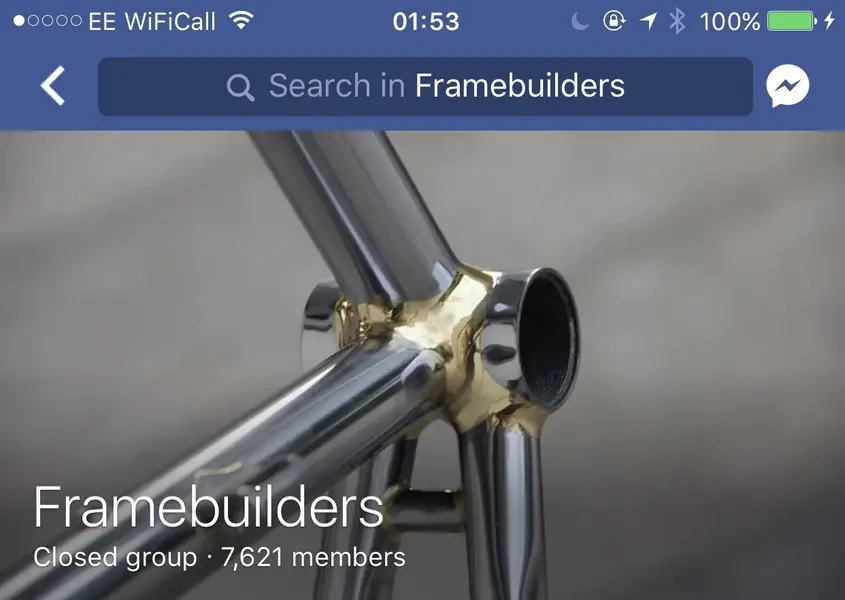

I joined a Framebuilders forum on FB. Some interesting thread posts from framebuilders on their preferred steel tubing to build a road frame.
