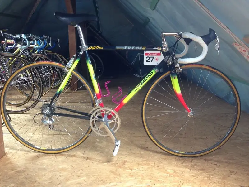

Nice bike,recently fitted deltas to my Lemond. Had a pair in the eighties so familiar with set up although still fiddly.
She looks great.

Thats a very nice bike but...
... for real authentic you need to paint the bottle cages in pink like I have done with the T.A. Specialites here
... Ergopower shifters will be changed quite soon (I need a bit of time...) to white C-Record brake Levers and down tube shifters
[attachment=0]TVT92_Team Z_GL 1991.jpg[/attachment

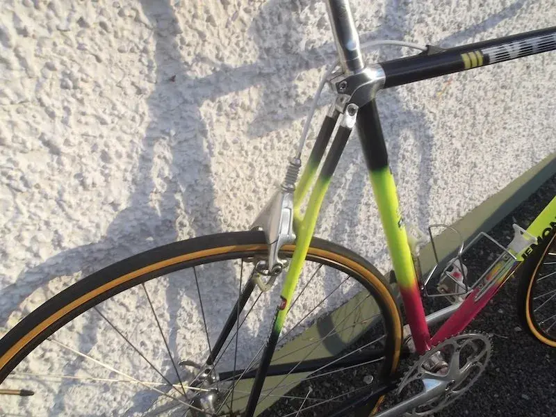

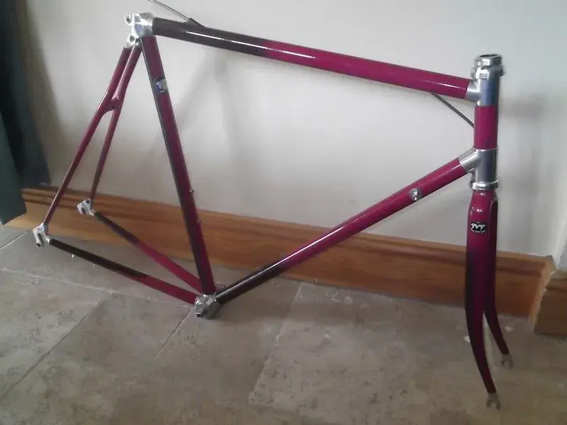

Thanks for all the comments/tips regarding the delta brakes. Yes, I will paint the bottle cages in time. I can't really claim to be authentic! I resprayed the frame in the garage over the summer. I will attach some photos of how it progressed.
