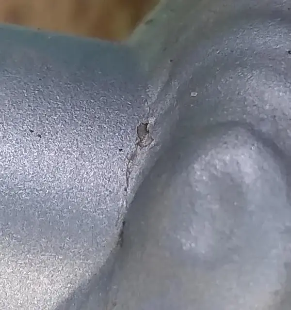

Whilst bike was upside down triple-quadruple checking the run out on the wheels I went over the frame welds again - does the below look like a bona fide crack/sign of something lurking beneath that would move under load/battering (NDS chainstay weld, underside)? Paint job is original and in true 26yrs hard labour condition, but that's the only flaking/chippng on any weld that I can see .
It's psychosomatic, you'll get over it....seriously though, get taking some paint off - doesn't look too bad there but could be worse underneath.
That doesn't look good I'm afraid.
Cheers all, really appreciate the collective wisdom (including the more pull yourself together lad ones, which might be close to the mark given how I tend to get when a niggle develops on the bike...!) ; I'll investigate on the lines suggested above over weekend and let you know how I get on...
