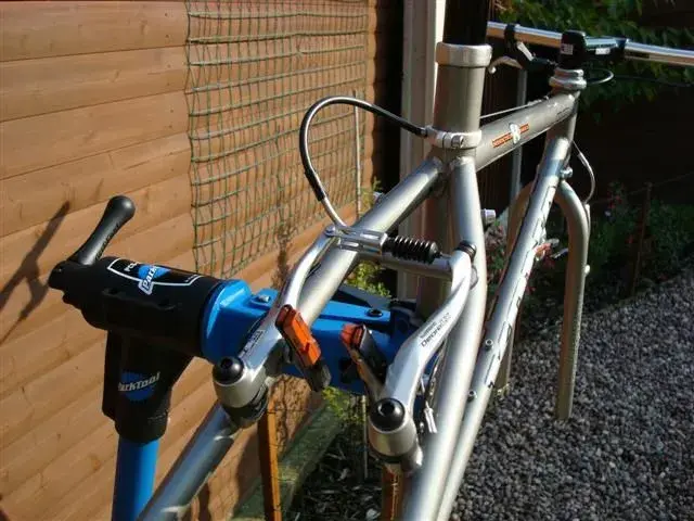

You can run v-brakes on Kona if you have the seatpost rear canti clamp, I have attached a photo below to see how it can be run, I think you have to make adjustment on the canti clamp by drilling a bigger hole from one side or have an extra cable stop brazed on top tube if you are going to have frame resprayed.
