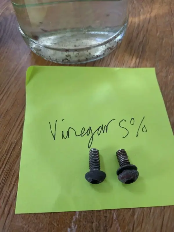

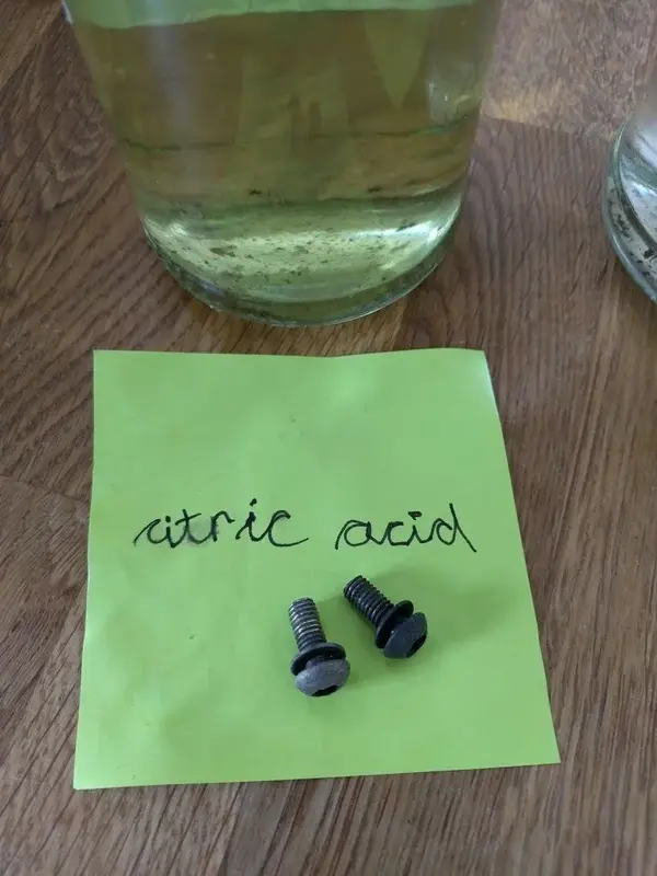

I did a science experiment with the kids. White Vinegar vs Citric Acid in water solution to remove rust. Citric acid is easy to come buy - used in home wine making.
Tried them both at 5% (White Vinegar is already 5%).
Citric acid is amazing. Just leave in overnight. No nasty chemicals... easy to get rid of.
Used it on loads of nuts & bolts now. I then tried zinc plating at home - but that's another story.
