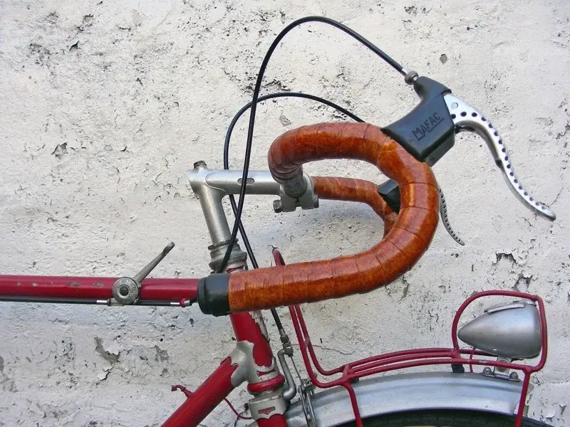

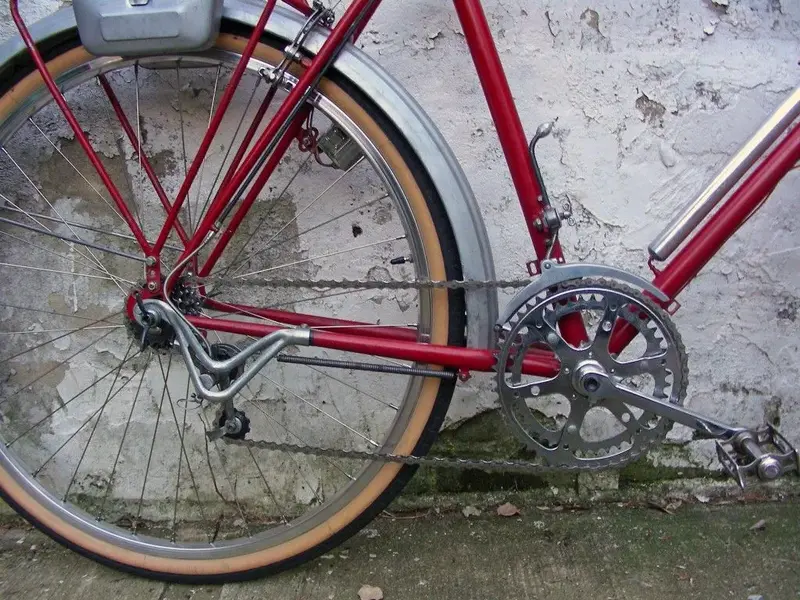

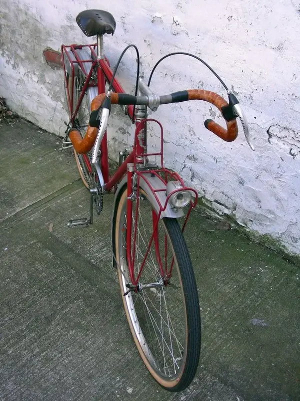

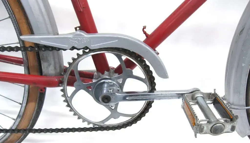

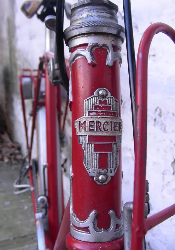

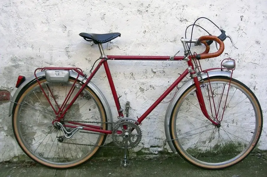

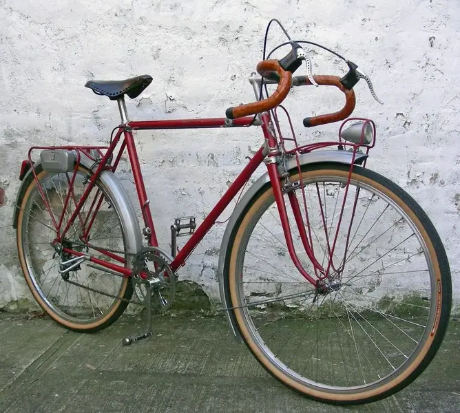

1950's Mercier 650B randonneur. Owners words below.
I recently finished restoring this classic French randonneur bicycle, a Mercier from the early 1950's. It's equipped with 650B wheels and a number of rare components only seen on French bicycles of the 1940's – 50's.
I acquired the bike from a French seller on eBay, and comprehensively restored it to the original drivetrain, while also making period-correct tweaks to the wheels, handlebars, and saddle to make it more comfortable to ride.

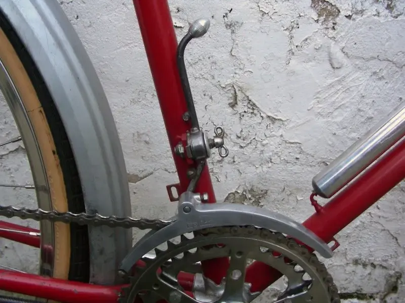

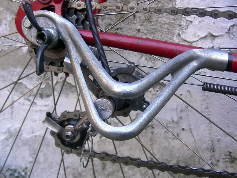

This type of derailleur is called a "chainstay mount" for obvious reasons, and can typically handle 3-4 speeds. Taking over from the more eccentric designs of the 1930's and 40's like the Cambio Corsa or Osgear, chainstay-mounted derailleurs were the most common type of derailleur until the mid-to-late 1950's, although still a minority when compared to the numbers of internally geared 2 and 3-speed hubs by Sturmey Archer and Sachs in the same period.
They were manufactured by a number of different companies, but the most popular were Simplex, Huret, and Cyclo. Their designs typically utilized either push-rod or pull-chain to move the derailleur cage horizontally across the gears.
The rear derailleur is a Simplex Route Leger, one of the most iconic designs of this style. It's partially obscured by the protector. Derailleur cage tension was achieved through an external spring that hooked from a mount on the chainstay near the bottom bracket to the top of the cage.
The front derailleur, a Simplex competition model with a rare cage that doubles as a chain guard. Sometimes referred to as a "suicide" derailleur, it's actually quite easy to use. The rider reaches down and gently pushes the rod inwards or outwards to change gear. The crankset is a no-name 50.4 style with 50 & 42-tooth chainrings. The pedals shown are Lyotard models, but I will be replacing them with rare Sanzax pedals soon.
The original wheelset was a set of rusty Rigida chrome rims laced to Maillard hubs, but I don't think they were original to the bike, since the rear hub was spaced to 120mm O.L.D. while the actual rear spacing of this bike was 114mm. I found a period-correct set of Liberia hubs, and laced them to brand new Velo-Orange "Diagonale" rims, and added a 4-speed Atom freewheel with 16/18/20/22 speeds. The tires are new Panaracer "Col De La Vie" 650B x 38mm.
Jeay brakes, a sort of early cantilever / centerpull design that was revisited thirty years later by SunTour with their "roller-cam" brakes. The saddle is an Ideale 92 Daniel Rebour model, with matching saddle clamp, and the pump is a vintage Solibloc.
The fenders and racks are original, with cool little tin boxes on the rear rack for tools. The front light looks to be JOS radios type, but I haven't yet had the chance to fix the generator and lighting.
Mercier 1950s 1.jpg Mercier 1950s 2.jpg Mercier 1950s 3.jpg Mercier 1950s 4.jpg Mercier 1950s 5.jpg Mercier 1950s 6.jpg Mercier 1950s 7.jpg Mercier 1950s 8.jpg Mercier 1950s 9.jpg Mercier 1950s 10.jpg Overall, the bike rides very smoothly and shifts gears well. I might put a set of upright bars on it soon, but otherwise I think it's finished for now. As an introduction to these mysterious and eccentric, but very beautiful breed of classic French bicycles, I think it was perfect. I'm hooked on them now, and already planning more restoration projects for the future.

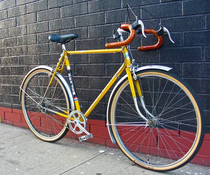

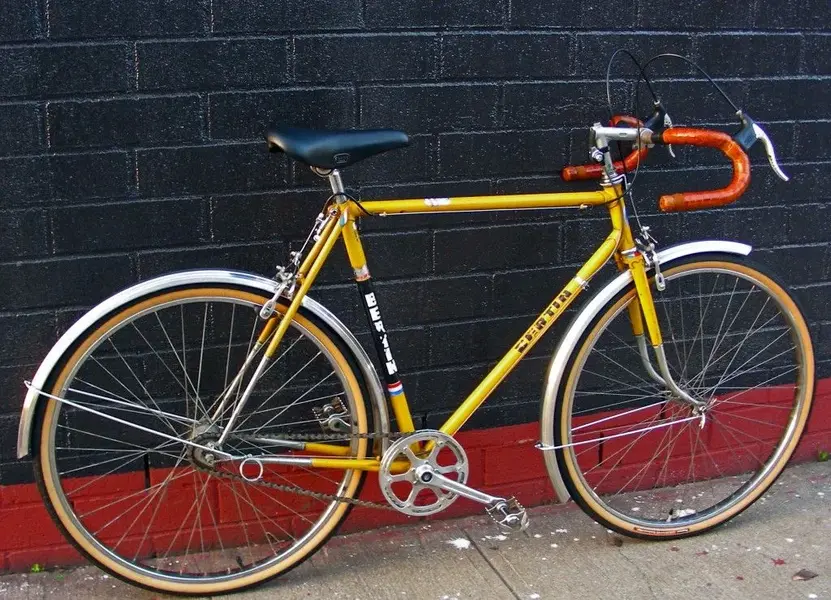

Andre Bertin 650B three speed conversion. Owners words below.

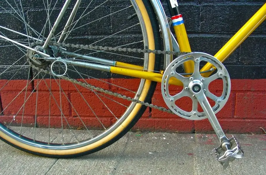

Made of Reynolds 531 steel and originally designed for 27" wheels, I converted it to 650B with the help of some long-reach center pull brakes. The rear hub is a three-speed Sturmey Archer, and I mounted the shifter on the stem. The crankset is a modern reproduction of the TA Pro 5 Vis crankset, made by Electra It has chain guards built in on both sides of the chain ring. I re-used the stem, handlebars, and MAFAC brake levers that were originally on my Mercier randonneur bike. I finished it off with some V.O Zeppelin mudguards and Panaracer Col De Vie tires.
This was one of those rare bikes that rode perfectly on the very first test ride around the block. Perhaps it was the fact that the stem and bars were already sized to me, or the overall simplicity of the three-speed system. Whatever the case, it's a fun ride and well adapted to the city streets with its wide tires and easy gearing. andre bertin 1.jpg andre bertin 2.jpg andre bertin 3.jpg andre bertin 4.jpg
