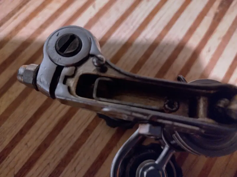

Making sure I'm on the right side of the line feeling slightly relaxed rather than anaesthetised the two little grub screws slackened and the top cover removed. Loosen the side nut so the n shape cable stop bar can slide up to the top. IMG_20221218_162902_HDR.webp IMG_20221218_165259_HDR.webp

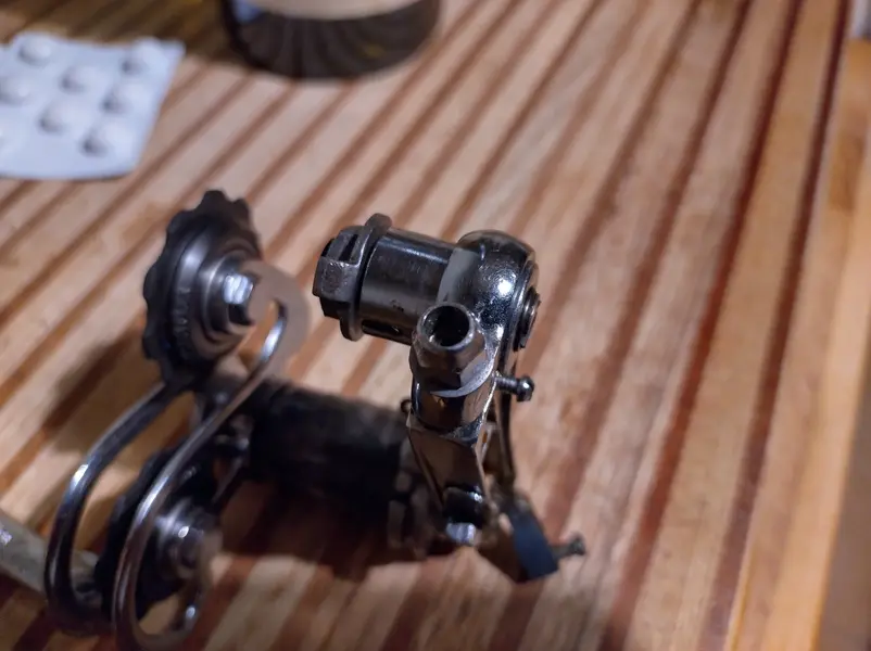

With the chain fitted the default cable slack setting is first gear largest sprocket like on the Tour de France, or back to front, steering wheel on the wrong side sort a thing. What looks like cable guide adjuster is the pinch bolt that allows the mech to slide on the boss to set first gear limit. IMG_20221218_162915_HDR.webp IMG_20221218_164739_HDR.webp

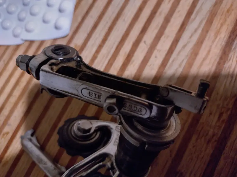

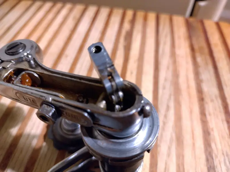

Fed the cable through the guide and into the toggle, take up any slack and pinch tight. Now shift to top gear smallest sprocket on your 3-5 speed freewheel. Once trimmed slide the n cable stop bar down to the cable clamp and nip up the nut stopping the cable pulling further. IMG_20221218_165439_HDR.webp IMG_20221218_162943_HDR.webp
Same as the 543 so no actual pre-sets as such and without the extra jockey cage cable which is a relief, the cage spring tension can also be adjusted. I was too pissed to read any instructions so fingers crossed..🤪🤞
Excellent write up there @vcballbat - some comments / questions though:
Interesting how they improved on the TdF, especially with setting the position to the large sprocket and having one RD for various blocks and wheel dishing. Wonderful brain melt-down idea to use that fixing pinch bolt to also run the inner cable through it - functionally whacked out to save drilling a cable hole elsewhere were there is little space left ;)
I found putting the cable in the pinch bolt at the end of a floppy bit of chain a real PITA on the TdF; almost a three handed job and lots of swearing with long nose pliers. This looks fiddly too, especially to trim the cable length - can you honestly get a cable cutter in there once attached?
To make it easier, is not best to initially and temporarily put a zip tie around the pulley cage and knuckle to compress the spring and thus to have a longer length of pull chain to work with, thread the cable in and temporary tighten the cable pinch bolt? Then release the zip tie and slowly loosen the cable pinch bolt which should result in no excess cable slack?

Cheers Woz, your cable tie hack is definitely going to be my third hand and to make things even more awkward my cable clamp/toggle chain has been turned 180° too far round so the clamp bolt is on the inside. Must have been like it when I striped it down but it's threaded into a blind hole and won't budge. I can't use too much force as I can only grip the chain but maybe I'm not thinking French and it's a left hand thread..💡 have to give it a go..🤞
