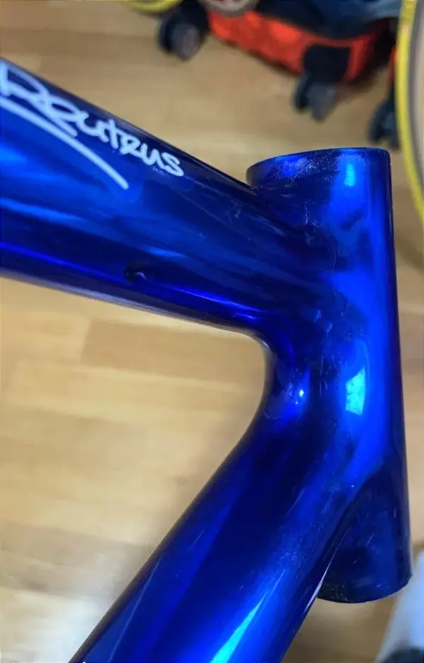

It's straight up and down, no taper or integral headset or anything. Good old fashioned for quill stemCan you post a photo of the inside of the head tube?
