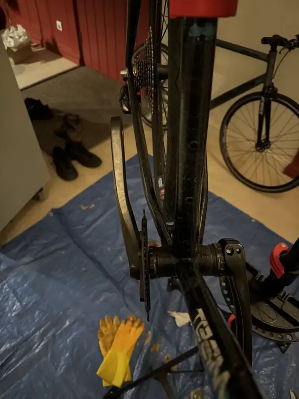

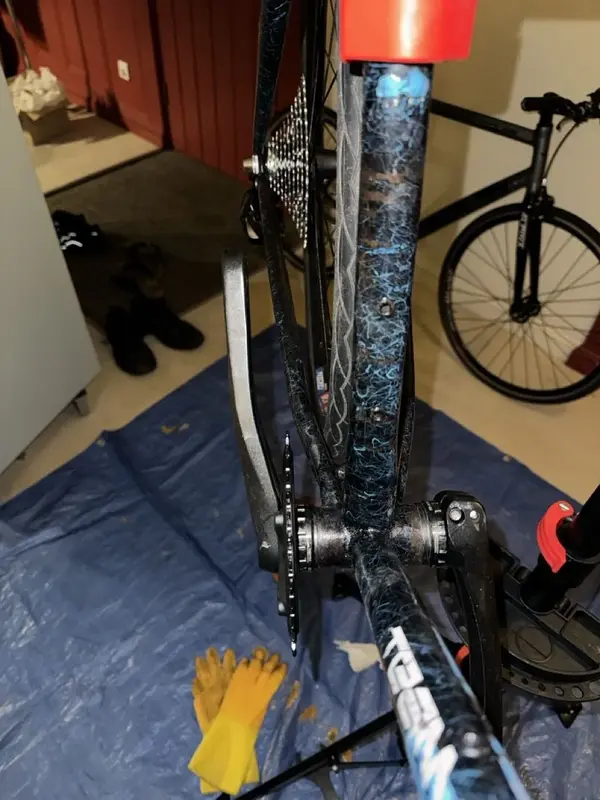

I'm building up a 1990s GT Avalanche. I've installed a MT510 hollowtech BB and then a MT510 12 speed chainset. However, now I've also installed the rear casette, I'm not getting a great chainline between the two - with the front chainring being basically in line with the last cog on the casette.
I've moved the BB washers so I have 1 on the drive side and 2 on the non-drive side, other than that what else can I do? Is it something related to the BB/chainset? Are there narrower BBs / chainrings I could get instead?

The smoking gun is that it will handle 142/148mm back ends. Check the installation manual, it will be something to do with spacers.
Can you not remove the spacer and drive the cup in further? Not that it'd give you loads I suppose
Or go square taper!
52mm is boost chainline. That's a bit naughty of Shimano listing that as compatable with 135 axle spacing in all honesty.
3mm chainring spacers are the way forward with that one
So would it be best to find a chainset with a narrower chainline? It seems all their single ring deore options have the same chainline:
Are there suggestions for other ones to use for a 135 rear spacing?
I've just done some Googling as this has perplexed me somewhat and came across this thread on pink bike.
Note at the end "I believe Shimano redesigned tooth profile on the new groupset's chainrings somehow to work well with a 52mm chainline on non Boost frames."
No idea how much truth there is in this but could be the case, Shimano must have a reason for listing it as compatible with 135mm where their other 52mm chainline cranks don't.
Have you actually tried it yet? I would say, if it works then run with it. Personally I would still put chainring spacers in though.
