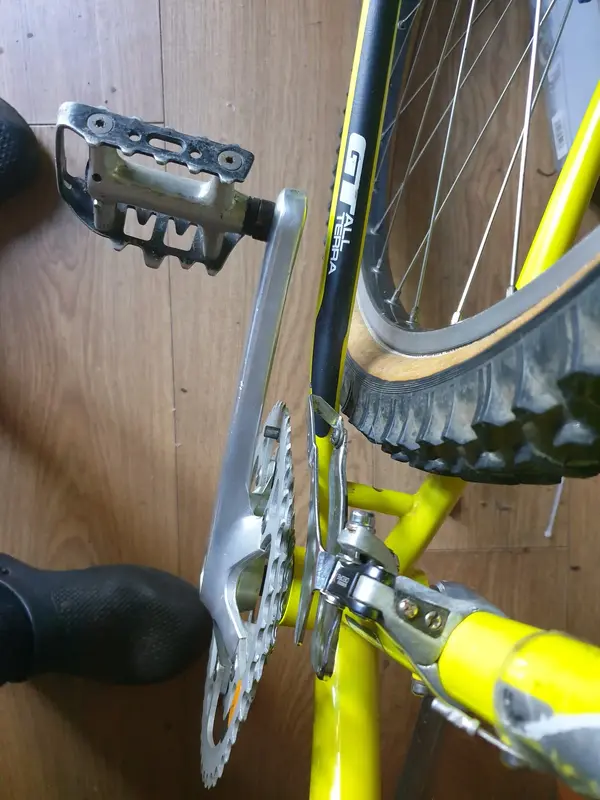

On that note, can anyone make any recommendations for spindle/axle length of bottom bracket for my Bravado? It has a bb fitted that just a placeholder, which is correct at 68mm shell and has a 120mm spindle/axle, which I think could be a little too long
You want the chainrings around 3to5mm off the stay once its tightened down, so it looks like you could lose 4mm or so from the drive side.
That doesn't necessarily mean dropping to a 113, because left and right ends reduction is curiosity uneven as the overall length reduces.
Take your bb out and compare drive sides to a shorter one👍
having just measured the distance, it's about 13mm on the drive side and 6mm on the non drive side between the cranks and chainstays
Usually if you get the drive side right, non- drive is OK.
It's surprising how many chainset/bb combos end up with uneven spacing between the arms and the stays🙄
But sometimes the tapers are stretched in the crank and the arm goes on too far. You could measure the step in the crank fixing bolt hole to the axle end and compare to check?
