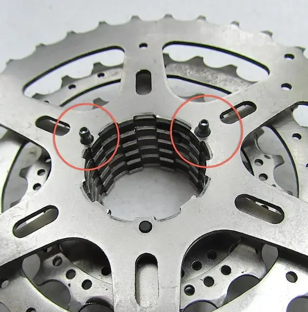

How did you manage to get the pins in the cassette out so you could mix and match sprockets? I read everywhere how people customize cassettes or use the spacers from an old 8 speed cassette to make 7 speed clusters work in modern hubs so I decided to do the same.
Long story short, it took me ages, a lot of sweat, and using the tools of my father-in-law to remove those pins. Now I have 5 nice spacers in the tool box, but if I ever need a 6th one, I’ll definitely pay the 1.5 EUR to buy a new one rather than going through the ordeal again. Am I missing some insider trick?

I think I chopped the heads of the rivets off and the cassettes fell to bit's.
I have several cassettes in bit's in my bin of "shitty old cassettes that I should really have chucked in the bin, but you never know there maybe a use for them"
I just had a look at the 28T sprockets in said bin full of goodness. I have knocked the heads of the rivets with a flap disc by the look of it.
I clamped the cassette between 2 blocks of wood in a vice then carefully used a drill on slowest speed to bore the ends of the pins out. Then carefully prised apart the cluster of cogs.

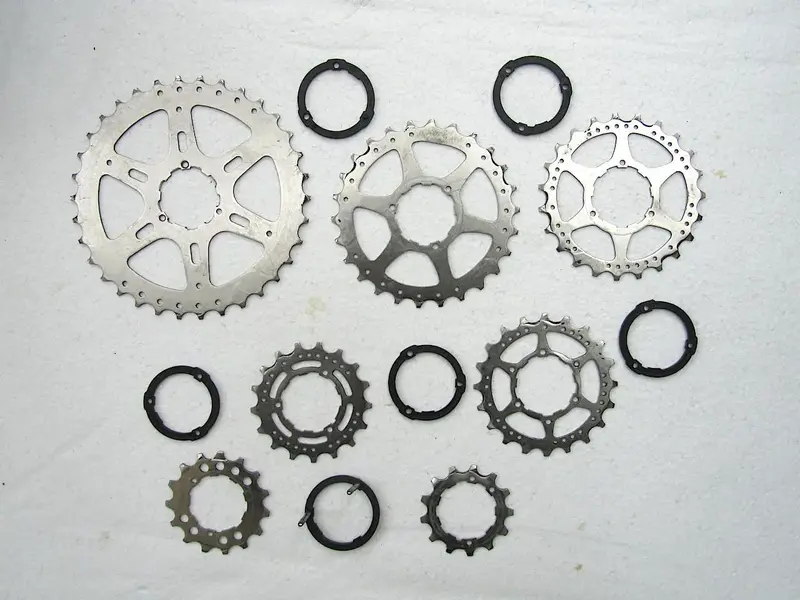

Once the rivets are loosened, you can dismantle the cassette and clean the parts. Smooth off the rivet ends with a file so you can insert them back into the customised cassette – although you can actually live without them too. Try and keep a note of the order and orientation of parts for reassembly.

Ok, here’s a trick. SRAM cassettes are held together with tiny Allen bolts so are really easy to customise. Plus, the 8 speed and 9 speed sprockets are all the same thickness, it’s just the spacers which differ. I know this is an 8 speed thread, but as an example I made a hybrid 9 speed touring cassette from a 12-26 Road 8 speed and a 11-32 mountain 9 speed to give 12-13-14-15-16-18-21-26-32 which gives a nice close set of gears in the 50 to 80 range with a couple of low granny gears. I don’t mind the gap between the 26 and 32 at all, it’s a chance to go a bit slower!! You could obviously pick your combination and keep the 8 speed set...
