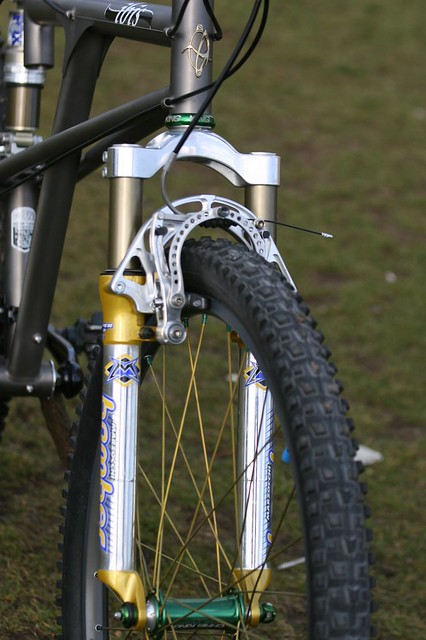

IMG_7763 by ten_sim, on Flickr[/img]
What's wrong with the S-Fly's ?
Nothing wrong with them as such, maybe a little short on travel at 63mm, and I'd agree with Lawson about them ramping up pretty quickly... I just really like the look of the carbon fibre Pace forks, and a set of limited edition (150 made I think?) 'Eddie Irvine' RC36's would suit the limited edition (263 made) Bow Ti nicely :)
Not so sure about the pink and green though... :?
Nice to see the yellow version of the S-Fly, you don't normally see them, just the sparkly black version like mine.
Been interesting info though, I've only ridden mine once, and other than what I got from finding out about what I bought.... I no nothing :D
