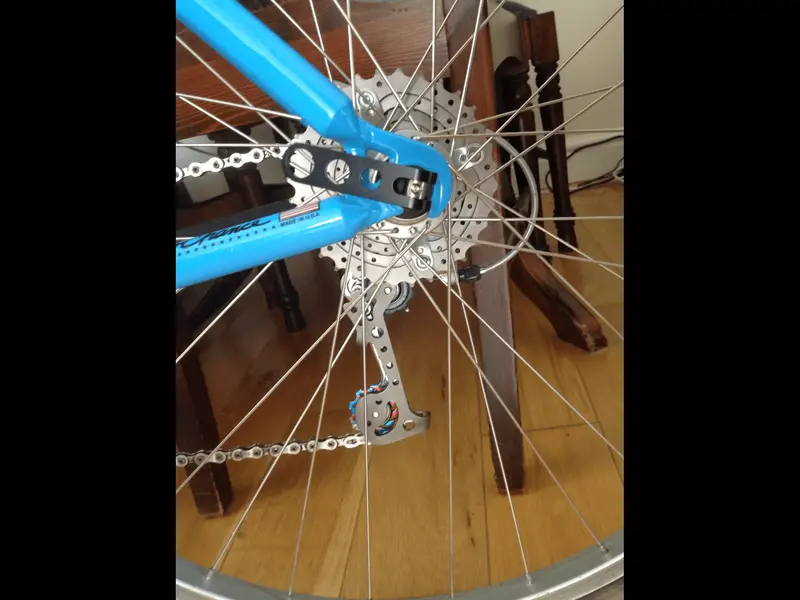

Here is a nice Build My 1993 Fat chance team Yo Eddy Aquafade
spec
Medium 1993 Fat Chance team Yo Eddy in Aquafade frame
Manitou 1 with matching custom painted lower legs with shocktech brace & Ultimate Machine Co titanium steer crown
Ringle Zooka Stem 120 1” Quill with titanium bolt & purple Ringle Face plate with Turquoise top Cap
Answer Hyperlite Turquiose handlebars
black foam none logo grips
XTR M900 1” inch Threaded headset
Grafton polished cantilevers F/R
Ringle polished MOJO cantilever hanger front & Grafton Fat Finger & one off Custom Aquafade Anodised
Grafton Shifter pods polished with XTR M900 Rapidfire shifters
Grafton polished Brake Levers
Syncros Titanium Seatpost
Flite Titanium saddle
Ringle H2O Turquoise & Purple splatter Bottle cage
Ringle Ti Stix Holey Turquoise Seat skewer

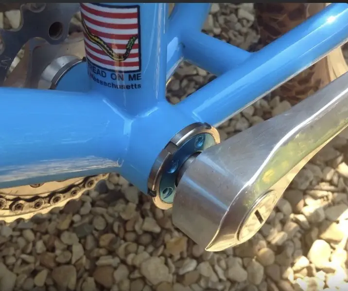

Grafton polished Cranks with Ultimate machine titanium crank bolts & Ultimate Machine Co turquoise chainring bolts
XTR M900 SGX 46,34 & ONZA BuzSaw 24t chainrings
Sram Hollow Pin 8 speed
ultimate Machine Co titanium bolts though out
Grafton turquoise & Pewter titanium Bottom Bracket ultimate Machine Co titanium locking rings
ONZA HO Titanium SPD Pedals With custom Turquoise end caps
XTR M900 Front Mech bottom pull with turquoise frame mounted pulley wheel
XTR M900 Rear Mech with Velta turquoise Alloy pivot bolt with titanium jockey wheel back plate & trick jockey wheels
XTR M900 12/34 rear cassette
Ringle Turquoise 32 Hubs on Bontrager BCX 1 & 2 Rims with Wheel Smith double butted spokes
Ringle Ti Stix Holey titanium wheel skewers F/R
Latex Vittoria inner tubes
Ritchey Red WCS 26 x 1.7 Tyres
weight 24 lbs
What stunning bike to ride

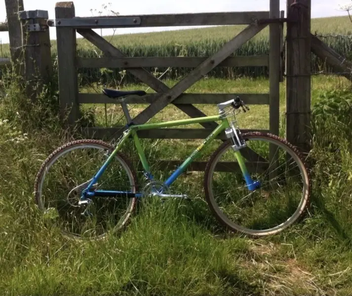

deligtful…nice how aquafade paint coordinates with your local agricultural landscape also😎 I miss my M/L Yo - ride was a delight
FATs are all about the ride but how many bikes look this purty ?
Yo Eddys are all about FAT tires. At least 2.3in. It was designed around a specialized 2.5in tire. The fat steel tubes are there to deal w/ fat wheels. Evry time a Yo gets 1.9 or even 2.1 tires, a puppy cries.
