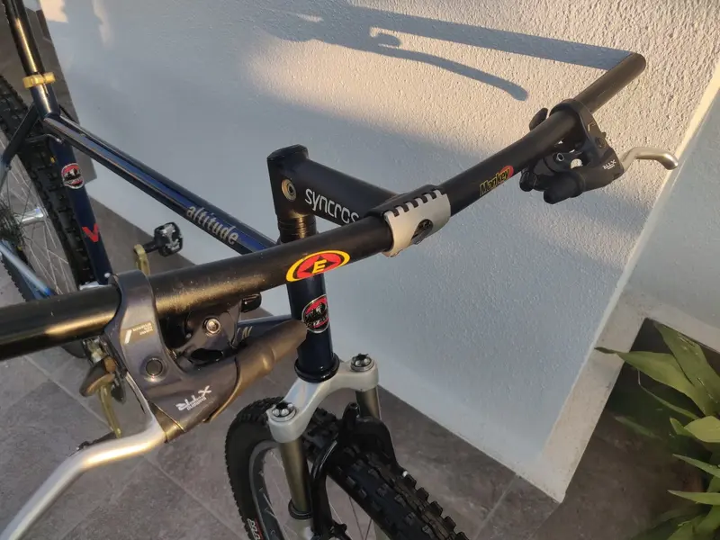

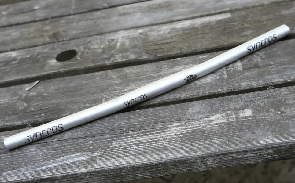

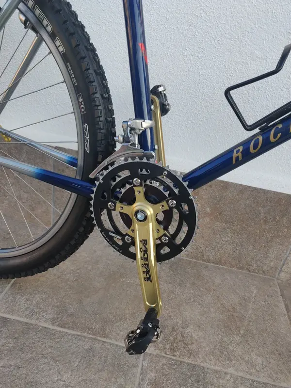

Considering this assembly 99%, fo you think a Syncros Hardcore handlebar in silver will match, because of silver clinch? I have one in black but its a late 90's early 2000's , which is "uglier" and worn. 1687295594792.png
Update. Crytics?
-Air leakage in left mag21 air valve.
-Riser handlebar. I need it to enjoy this ride.
- Syncros stem is chunky but i like it
- Thank you to who recommend the black scheme
- I have a candy ti gold to install also.
Thank you for all comments, ggod and bad.

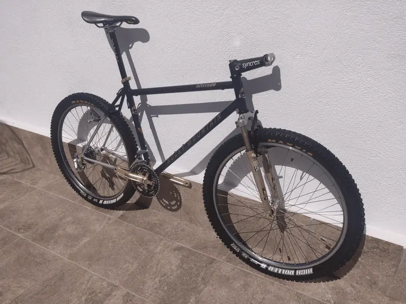

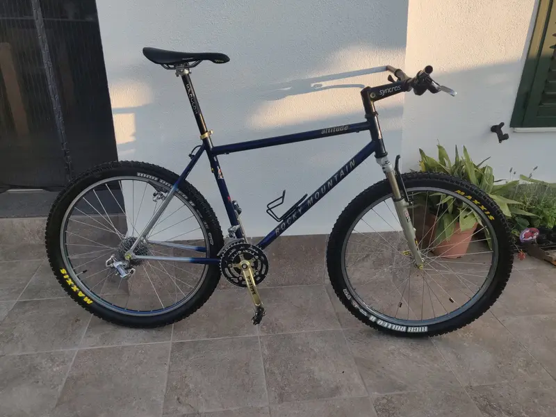

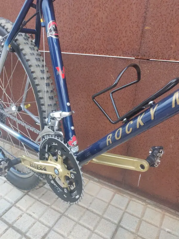

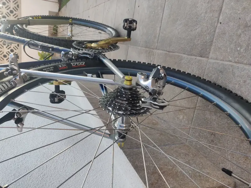

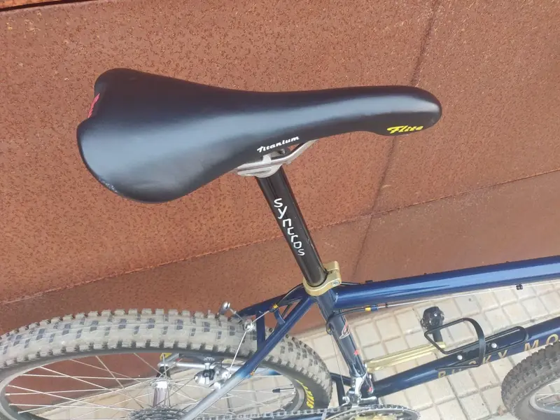

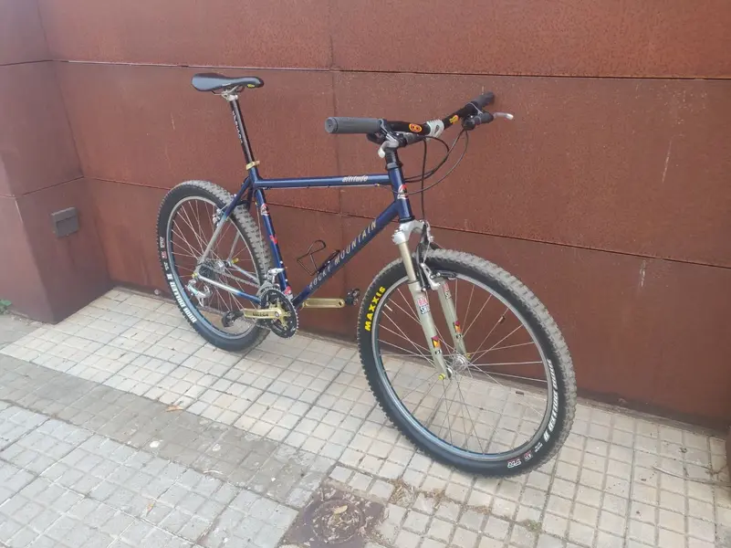

I like it. The gold/blue colour combo is killer. Nicely done bud. I would stay with a black handlebar BTW but that's just me; anything Syncros colour be damned wouldn't be bad either!
Tyres are provisional. What would you use? Panaracer smoke classic would be ok I think. Tan wall will match well.

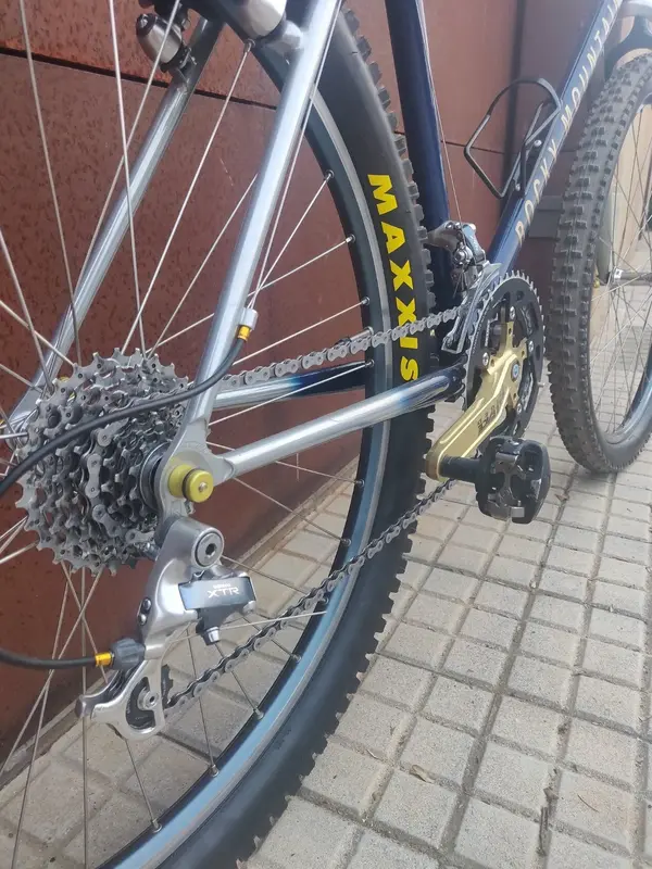

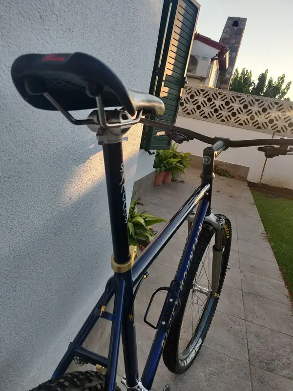

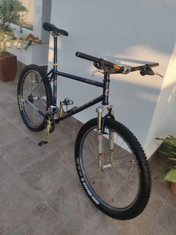

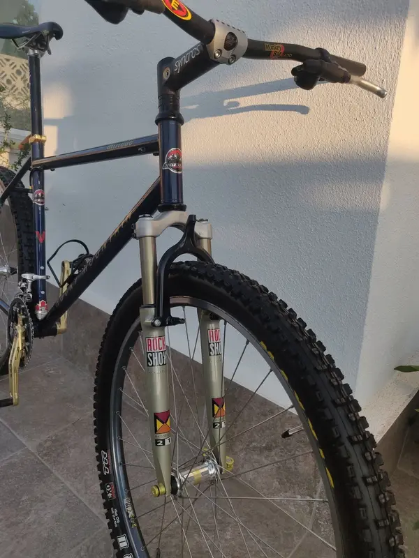

Here a fast assembly.
- Tyres will be replaced for a Panaracer Smoke Classic. This one touch the FD when using granny one.
- Handlebar is not the best optin but it's great for handling and wide, if I want to enjoy it on the mountain. I will have a 560mm syncros one and maybe I install it from time to time.
- Grips are Ritchey modern ones, and they work. But maybe I look for something better.
- I will replace the sSyncros for a shorter 120-130 one. I feel the bike very long for enjoying it properly on the mountain.
- I have to cut the steerer ( 225mm) a litle. I wanted to avoid, but I needed to many spacers and it looks ugly and I can ride well with 5-8mm less.
Please comments!
