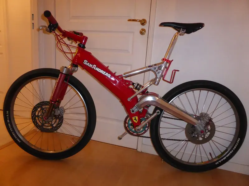

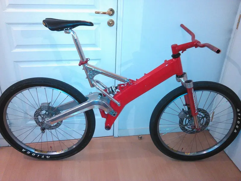

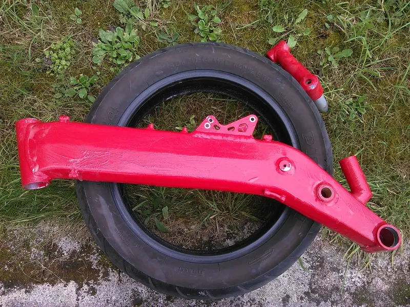

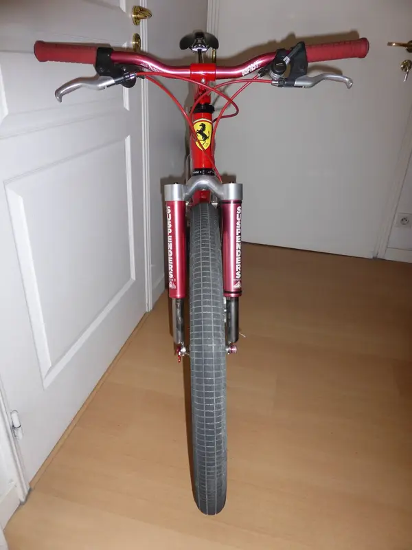

Now that the bike was cleaned and undressed, time had come for a more ambitious work: get rid of this awful Ferrari paintjob, something I've never done before.

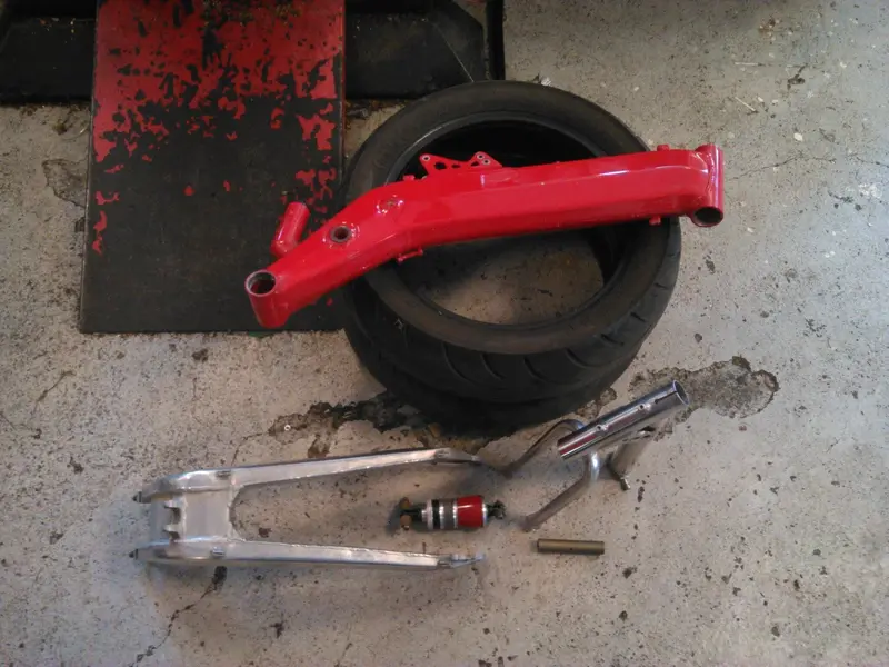

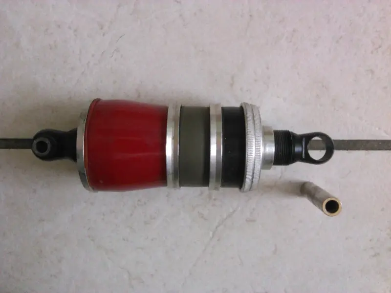

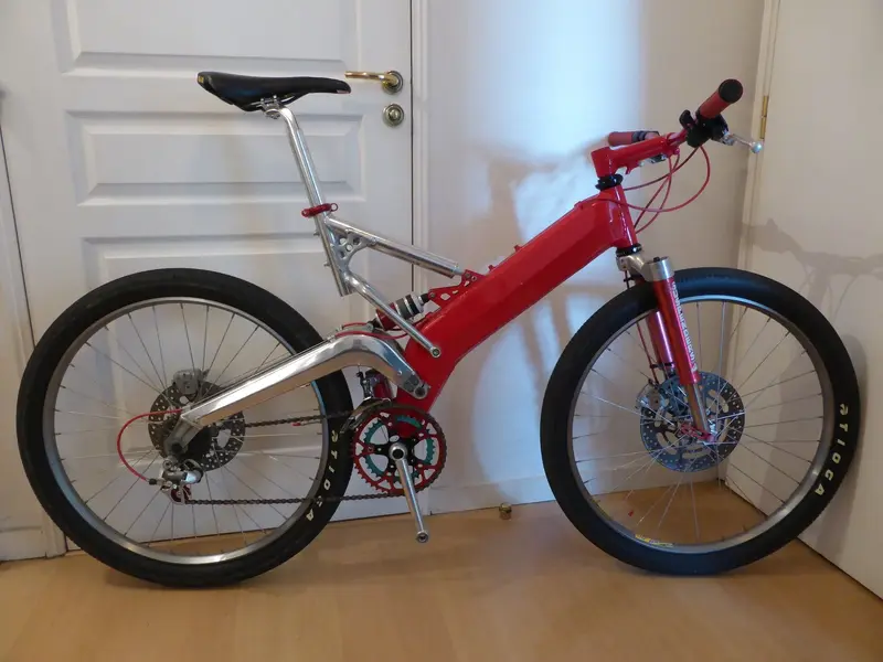

Do you remember the strange noise I was talking about earlier when the bike was moved here and there? While I was disassembling the frame, I noticed that the bushings from the top shock mount were completely missing, thus leading to a gap between the shock mount and the frame axle. Hence the noise each time the shock mount was hitting the frame axle when the bike was pulled up/laid down.

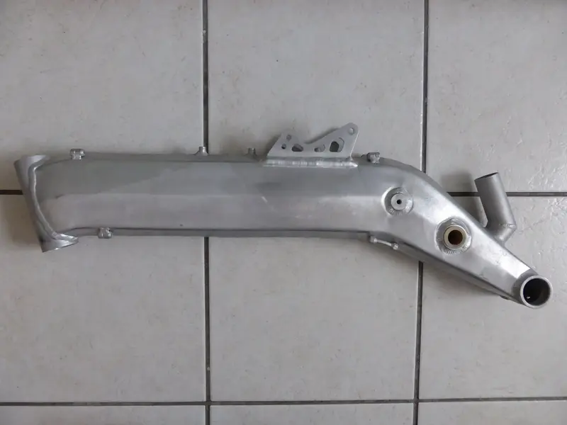

As I was concerned by the swingarm removal, I felt more confident working on it at a friend's motorcycle shop, just in case (cheers Gilles!). Thanks to this RB thread [1] and a detailed write-up with pictures of a German board I can't find the reference anymore, all went flawlessly in the end. Upon removal, I also noticed that the rubber O-rings referred by both the RB thread and the German board were missing.

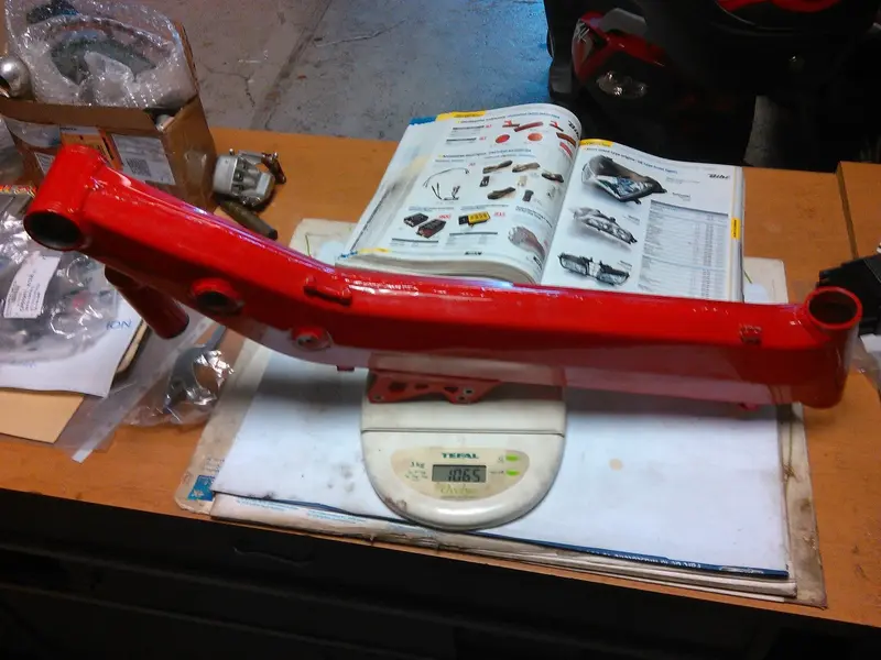

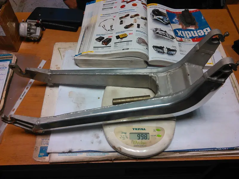

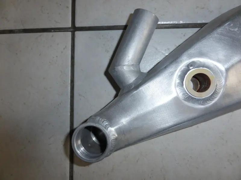

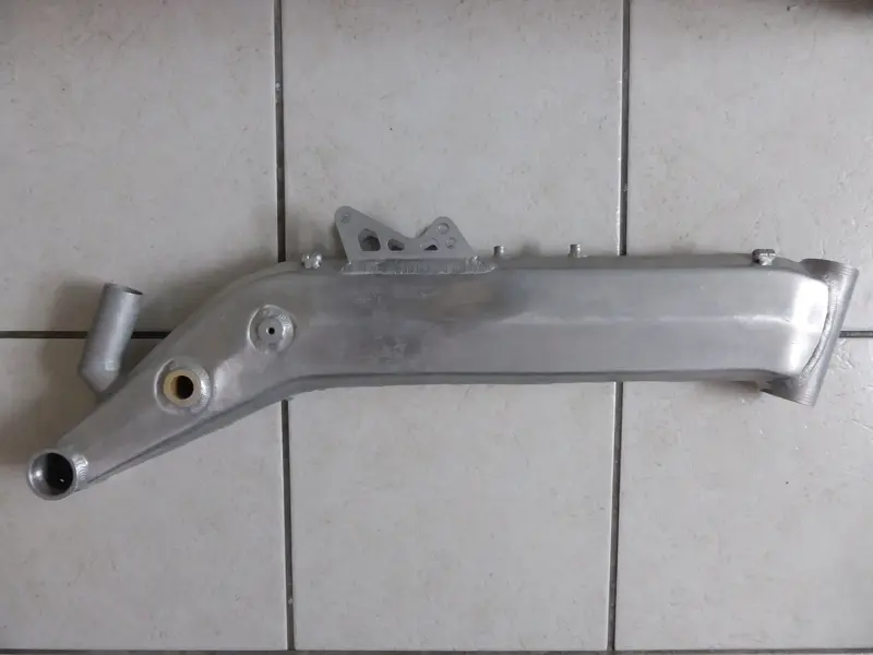

Don't ask me why, but I took the opportunity of having the frame totally disassembled to weight the monocoque frame, subframe and swingarm, including the mounting hardware.
OK, OK, maybe also because of the following story, I admit 😉. In 1992, my father bought a Specialized S-Works M2 Pro MTB, a rather light bike. Shortly after, frame paint started to peel off and joke/legend was that Specialized saved weight up to the paint. Since then, I've always wondered how much paint can weight. More on this later...

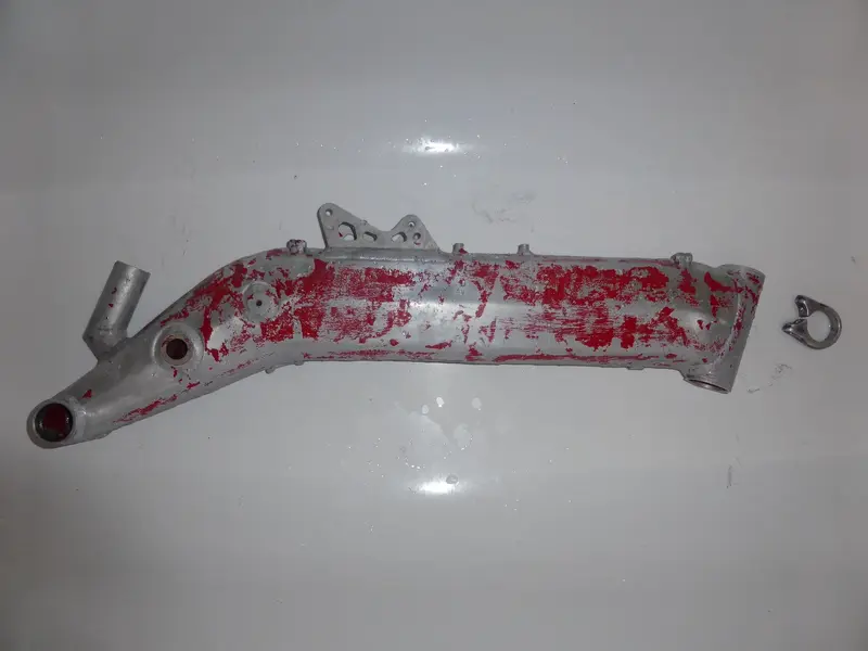

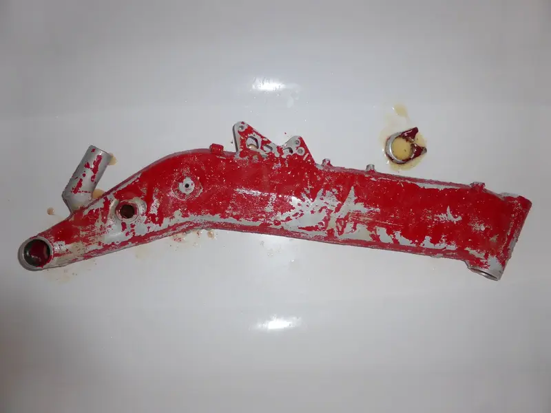

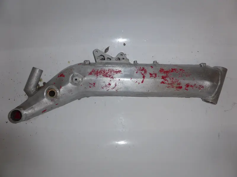

After numerous readings on ways to remove paint without altering the underlying support, I opted for a chemical approach using paint stripper.
Although the paintjob was well executed, it seems that the coating was luckily not that thick and lacked a primer. So, besides applying several layers (seven, IIRC) of water-washable paint stripper for roughly two hours and brushing the monocoque frame with a pony hair brush to desquamate the paint without scratching the aluminum, I didn't had much to do to achieve my goal.

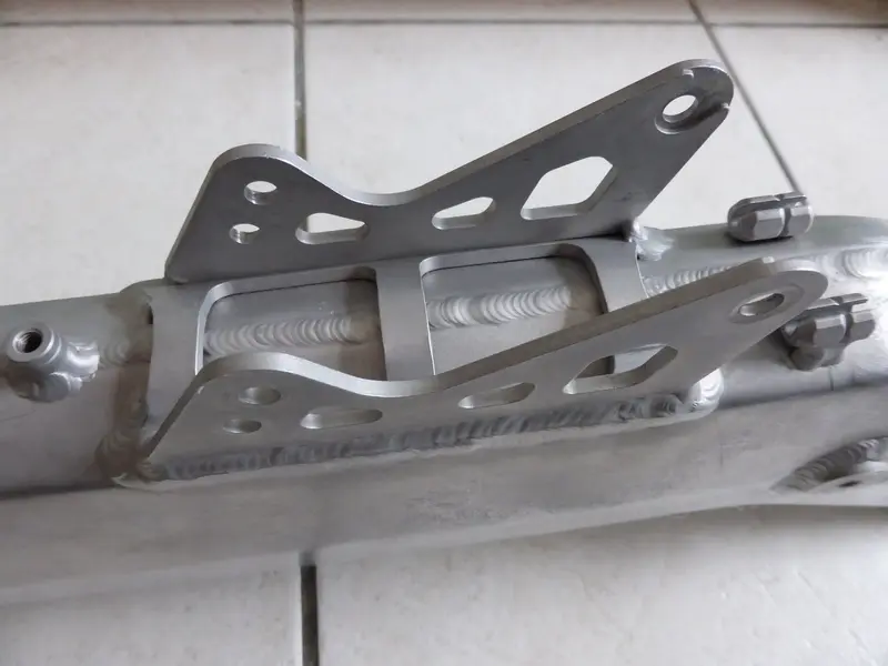

Interestingly, the outlines of the original '91/92-style decals were still visible.
I thus recorded exact measurements for repro decals and later accurate re-positioning. Additionally, I was now certain that my San Andreas was a '92 model.

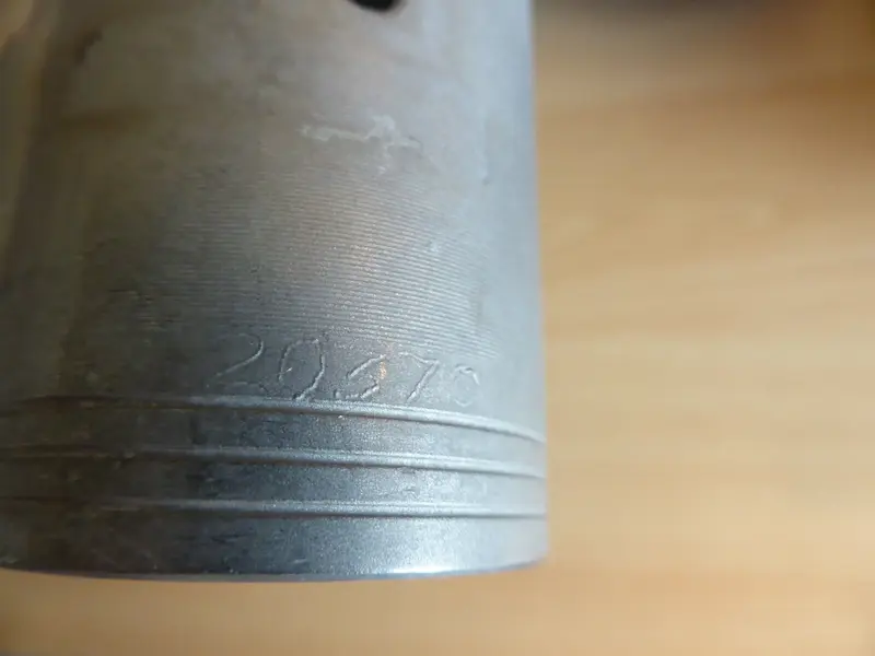

And there it was, barely noticeable, hand-etched underneath the bottom bracket: S/N #20370. Nice to meet you, Sanny!

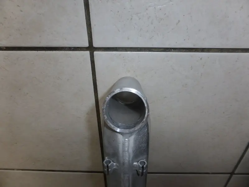

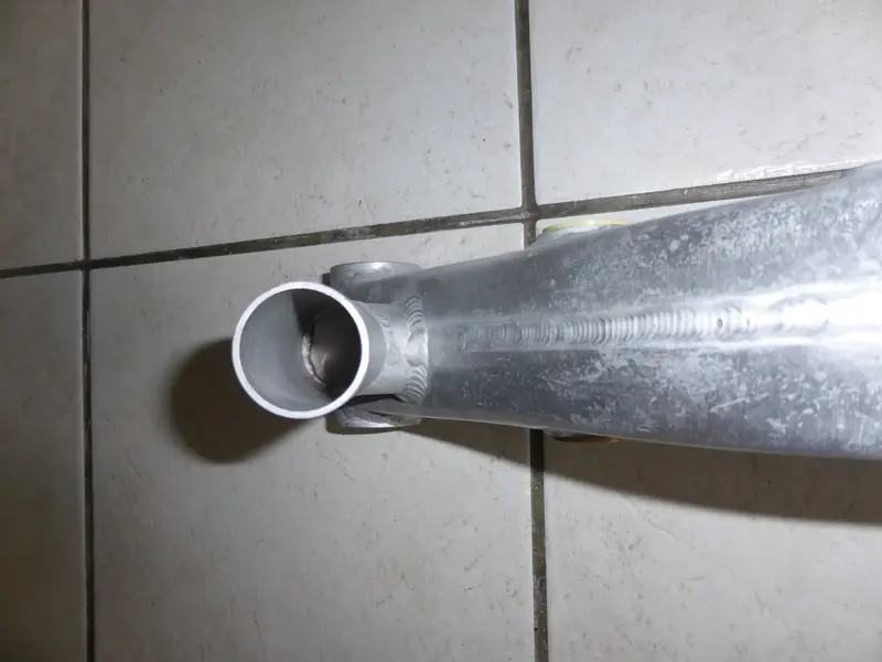

Interesting how mc welded two halves of the frame together to make it🤔
