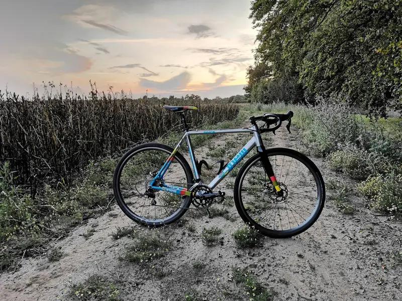

Quick spin down the local paths last night to get acquainted with it.
Rear brake is able to lock up which is great but front seems a bit soft. Will get add some pads to the shopping list!

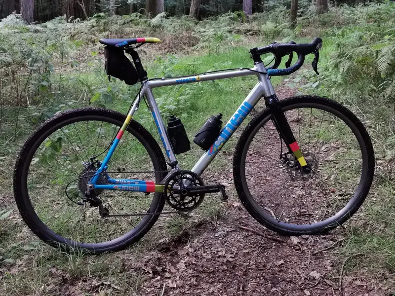

A couple of weeks later and it's now in a place I'd call complete. I've since fitted:
New Swiss stop pads
More new brake cable (didn't need the inline adjusters so wanted them eradicated)
Bar tape (supacaz fade)
Absolutely fantastic to ride and so much fun at the same time. I've even found some new tracks in the area as well.
A pic from tonight whilst in some woodland.
