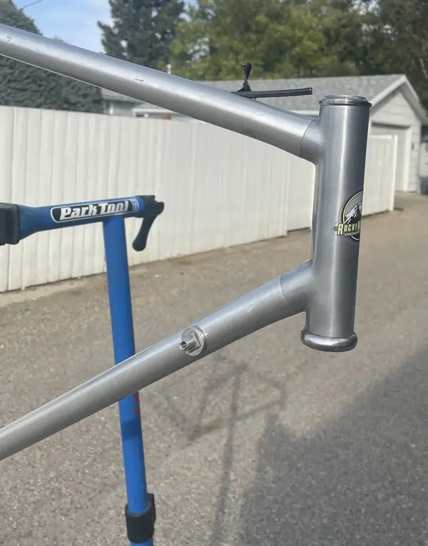

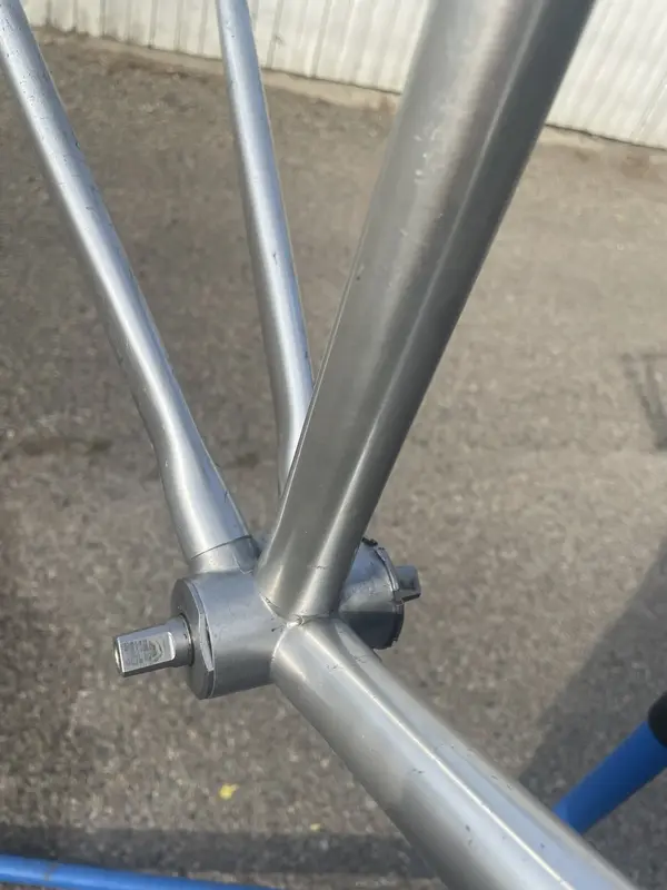

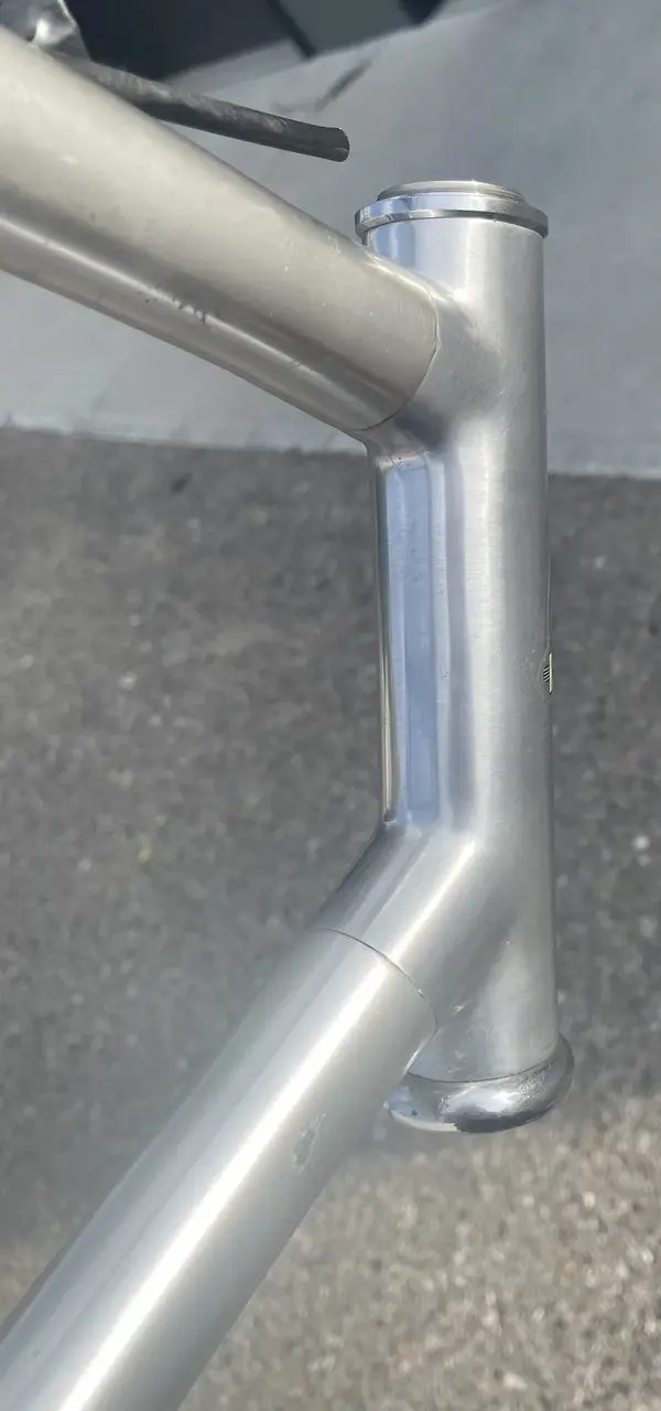

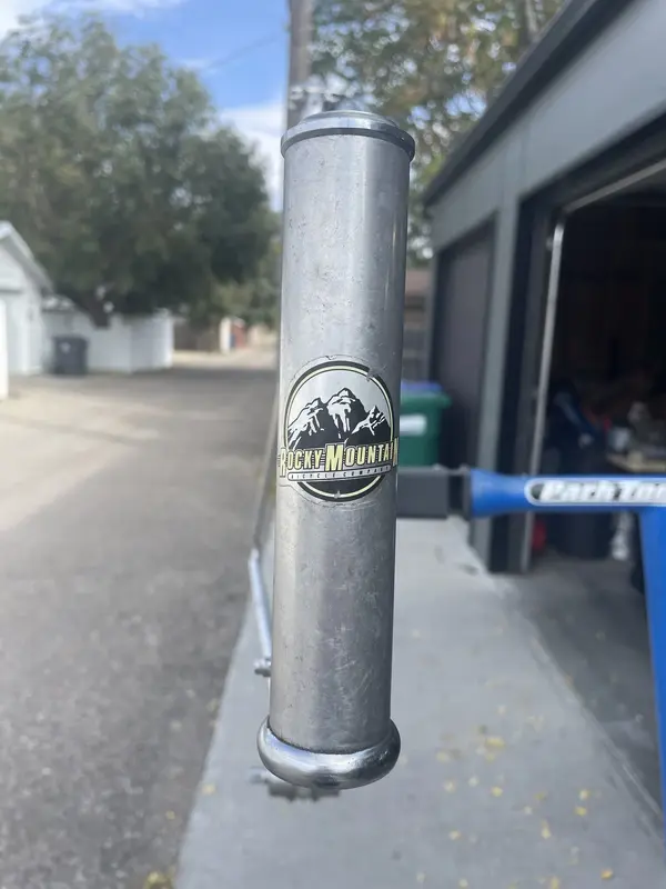

Ok Pictures after a strip- there's really nothing that this thing apart from any other Vitus 979 frame from what I can tell based on internet pictures, apart from the Rocky Mountain stickers on the head and seat tube which look original- there are faint evidence of "Vitus" decals on the top tube. that I tried to capture. I don't know the direction of build yet, I honestly don't know what I'm doing lol. I'm going to start with a good polish, and source a pair of Vitus 979 forks for it. After a little bit of elbow grease with some scratch pad and wd40, I think this frame will polish up really nicely.
On to pictures- You can kinda see how well the frame has been cleaning up so far. I'd like to take my time with this polishing. Ultimately I'm looking for a satin lug look. I'm excited for decals- I think I'm doing a typical rocky downtube... but which era and colourway? I think I'd like some fun 80's colours in the decals- then I'd like to do the "Vitus" in the typical model location but in the same font and Turbo and Giro.
can anyone help date with the decal?

You'd think that RM would have mentioned a collaboration of this kind with Vitus in the period literature, but I can't find anything.
Yeah, I've scoured everything with no mention- I'm only seeing pictures of other people bikes. A red one and a black one but neither really say anything about WTF they are or why.
Interesting bike. No expert here, but I wonder if it could be manufactured in Asia since their mountain bike supply chain went to Asia and everything I've read indicates Derek Bailey brazed his frames together.
I guess I should update this thread-
Yes this has nothing to do this Derek Bailey, he was still in England in 86, and this was built in France. It's a Vitus 979 branded as a Rocky Mountain. Side note- Vitus built frame sets for many other companies who wanted to offer an aluminum frame set but didn't have the capabilities. You'll see these branded as Vitus, Peugeot, Motobecane, etc.
I haven't found any scans of ads, or catalogues, etc that confirm this bike anywhere, whoever others do exist...
Which is a beautiful red one with the newer seat binder. Which is why I'm thinking this would date these around '86, because Vitus made the change about half way through 1985 from my understanding.
A white one, again with the newer seat binder.
There's also a black one I've seen online. You're right vtwinvince I can't confirm Rocky Mountain stickered and sold these Vitus frames, but with others that exist, we know someone did.
