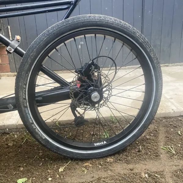

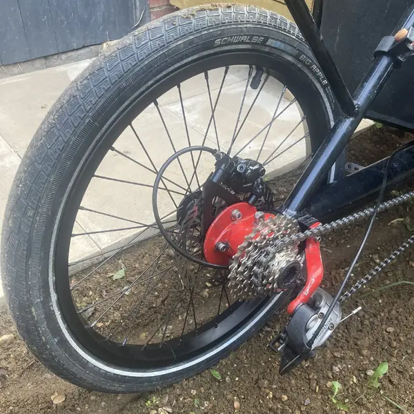

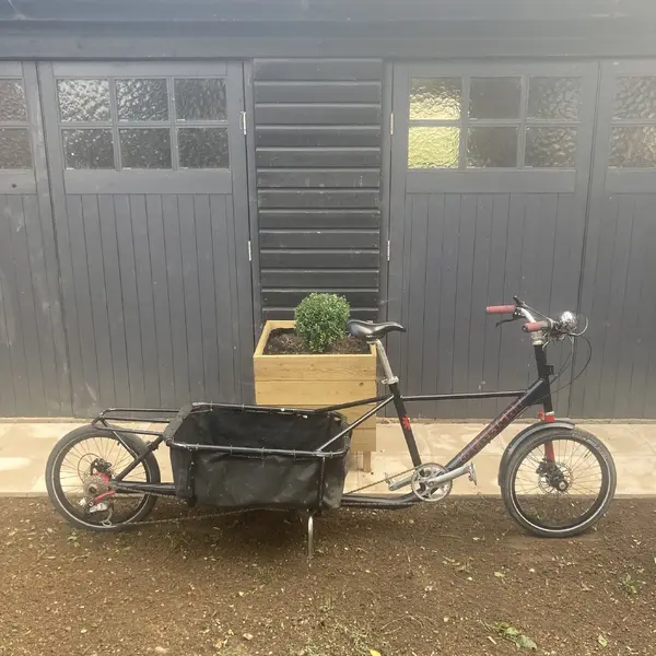

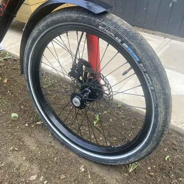

Last year I converted a local customers 8 freight to front and rear disc brakes so had a lot of contact with the original wheels and modified a pair of Hope hubs to work with the original axles of the 8 freight.
It was a LOT of work to machine inserts for the hubs with a 1/2” broached hex drive for the rear axle and press/bond them into place.
If you get stuck, I can ask the customer if I can borrow his original drum brake wheels to take some measurements from, even potentially convert a hub for you if you can’t find anything.

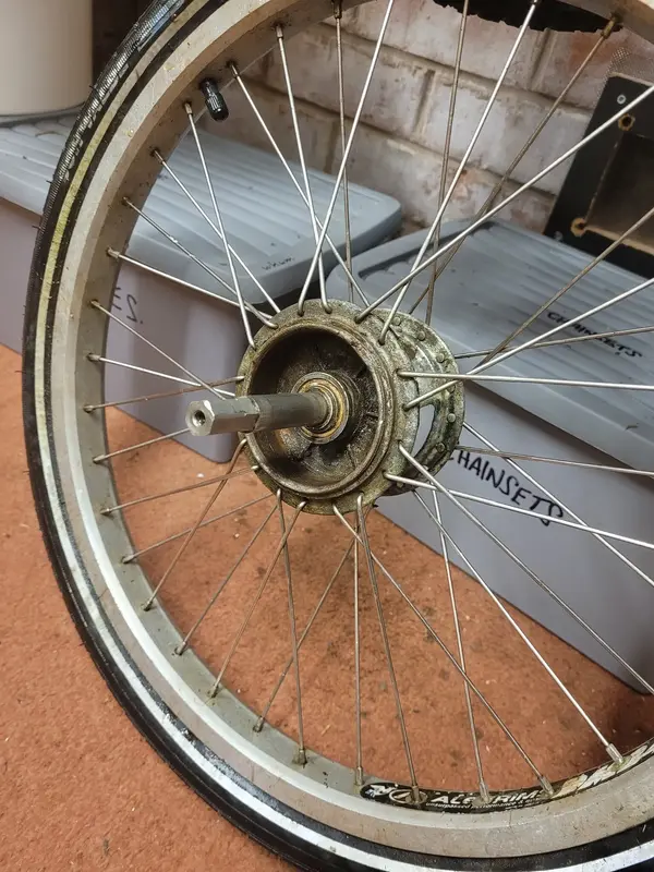

My 8Freight has a 70mm Acelo rear drum/hub, I guess similar to sturmey.
The hub has a piece of aluminium bonded in that effectively makes the hub solid, and this piece is broached out to the hexagon form of the axle. The wheel is held on by a washer and m6 (?) screw.
The front has just got a housing for the two bearings. Again 70mm.
