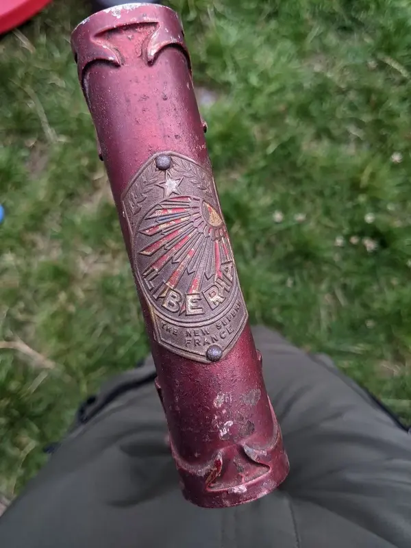

An evening on ebay has yielded me a 1950s French Liberia randonneuse frameset with Durifort forks and unknown steel frame tubing.
It is my understanding that Durifort is a French brand for "tuyau de gaz extraordinaire" - the French Reynaults so to speak.

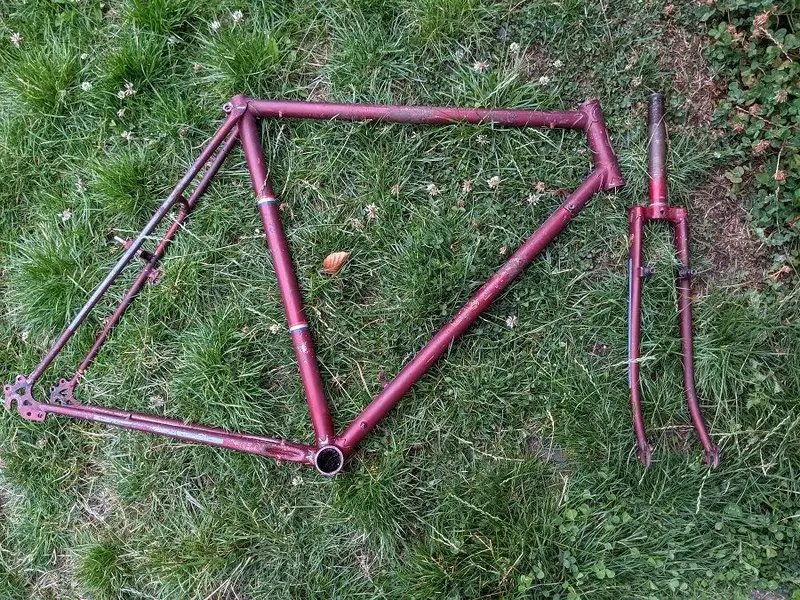

The frame was purchased from a seller called street-of-vintage-bike-2 who turned out to be quite a friendly chap. He listed the paint condition as "very bad" but assured me that damage & rust were purely cosmetic, and the frameset looked structurally sound.
I was reluctant to believe him, as the pictures, that made the Liberia look like a badly rusted frame in merde brown colour scheme. Not that I don't trust French ebay sellers, but it's more that in France a "structurally sound" frameset means that at least one of the seat stays is still attached to the seat tube and the rest is firmly secured with gaffer tape and jubilee clips.
Shipping from Grenoble (the hometown of Liberia bikes) + UK import tax cost as much as the frameset itself, but I didn't care that much, as my head was spinning with dreams about the new idiot bike project.

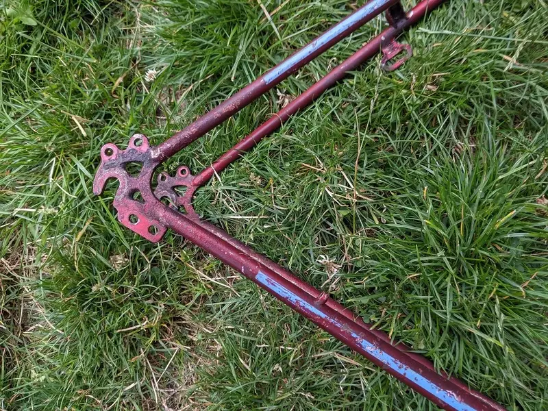

A bit about the frame:
The weight for a 57cm frame+forks is only 3.2kg. Quite light by gaspipe standards I think. Fork is 800g - the same as my Reynolds 531 sloping crown Bob Jackson.
Seat tube angle appears to be 72.5 and headtube looks like 72.5-73.
BB is French threaded - not a big issue these days.
96mm front spacing;
116mm rear spacing (!) took me by surprise, as the frame is equipped with an old-school simplex hanger;
The fork race diameter is 27mm, and the fork threads are 24tpi, so standard ISO/Italian/JIS. WTF Francois?! I wonder is the frame builder was guillotined for treason for this grave mistake. I'll try a JIS cup to see if it fits well into the headtube, otherwise, I'll need to order in a 27.0 Italian headset.
There is one downtube shifter mount, but it's not the modern M5 x 0.8. Could this be M5 x 1.0?

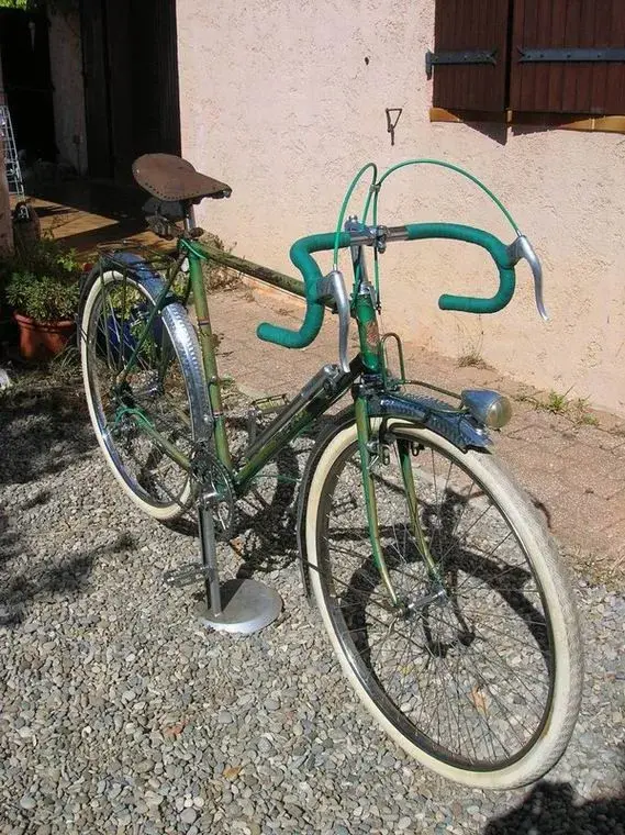

A bit of searching on the French bike forum has produced a photo of how the original bike looked like - see green pic attached.

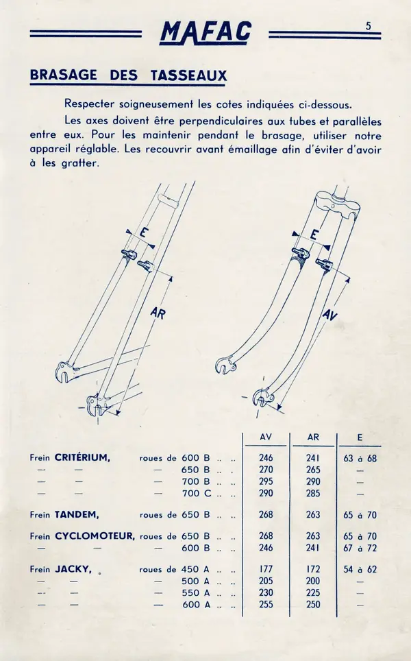

- It appears very early canti-lever thank god. Not sure, but you may need to run with Mafac of that period. This table could help.

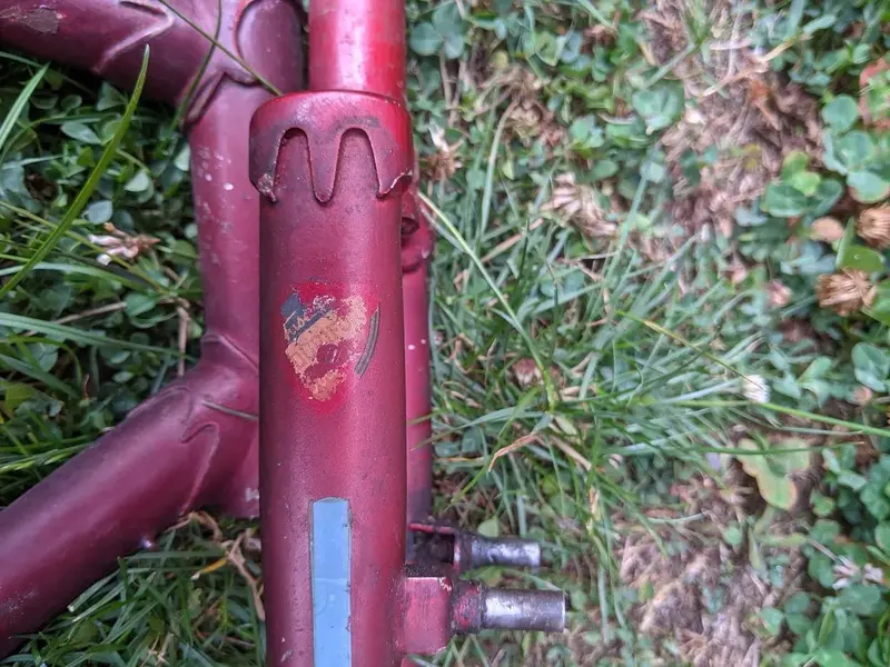

Apart from weight, one of the selling points to me were the canti mounts. Looked modern in the photos. The threads are "normal" M6, or whatever is used in bosses these days. The boss diameter is 7.9mm - same as modern ones. Bosses are non-removable (not the modern threaded type).
Beware of old frames - some of them looked like they might have canti mounts, but on closer inspection were equipped with some prehistoric brake-mounting contraptions that would probably be completely incompatible with modern brakes.
Don't have cantis, but I've tried putting a set of v-brakes on the fork and they fitted OK-ish, albeit the pads were at the absolute bottom limit of their adjustment. I assume that the frame should accept modern cantis.

2,4 kilo frame, could be more than just gaspipe?
I know, right?
I believe some French builders used metric 531 in the main triangle & durifort for the rest, but the seat tube is definitely seamed.
Another possibility is butted Durifort - supposedly a popular tubeset prior to Vitus acquiring Durifort in the 60s(?). I've read that it was seamed and then rolled, & butted removing the traces of the seam. The seat tube does not appear butted to my eye if I shine the light into it, and there's a seam - not very noticeable, but it is there.
I can't see what's inside the main tubes - the bb shell is packed with grease.
My biggest fear was that the frame was about 3kg originally and half a kilo has rusted away. But no, the frame condition is pretty damn good for its age, apart from cosmetic pitting on the outside.
