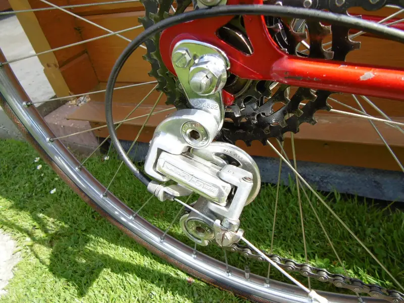

Any reason something like this won't work after a bit of filing? Bolt it to the lower eyelet.
Bolting to the mudguard eyelet? Might not be much left for nut or quick release to land on when filed to line up with the dropout....
Yeah good point.
I could probably just make something out of 4mm alloy plate to bolt into the lower guard eyelet and the left simplex mounting hole. An hour with a file and a hacksaw should do it. But I don't have an M10x1.0 tap.
