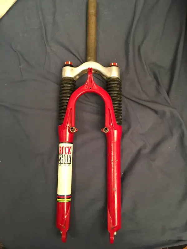

The forks seem to be absolutely fine, no play or sticking, but my experience with them is zero so maybe they aren't fine at all. I plan to strip them down with a view to replacing any damaged or perished parts, and maybe even upgrading them with some SRP goodies.

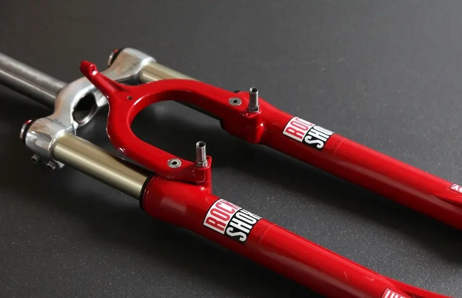

As above, though oddly your 'DH' look more like red pained SLs, the crown is an SL/XC crown but with a steel steerer, not a DH one and the bolts and studs are way to nice looking.

As above, though oddly your 'DH' look more like red pained SLs, the crown is an SL crown but with a steel steerer, not a DH one and the bolts and studs are way to nice looking.

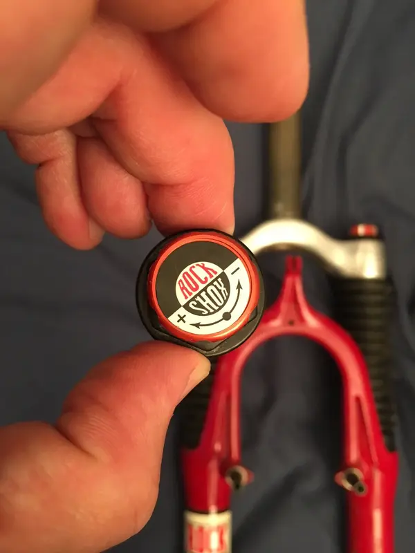

That pic is one I found online, mine are still on the bike and muddy from the last ride, will post pics when removed and clean.
I'm interested to see what's inside, and I quite like the idea of getting the SRP cartridges and springs.

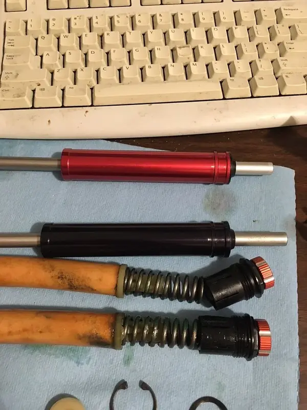

The dh versions should have a damper in both legs. The ones I've had were metal bodies, not plastic so less prone to blowing. Iirc one was red anno, the other silver.

here is what the oem insides look like .....
