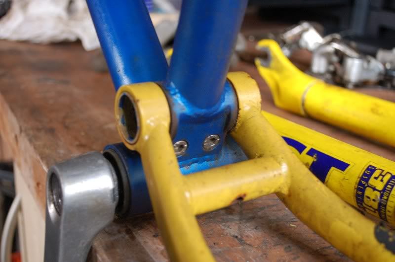

So, removing a crank arm that has no threads for a puller.
My though was, using a hacksaw cut along the line shown below and then use a cold chisle to break the arm. Anyone done this sucessfully before?

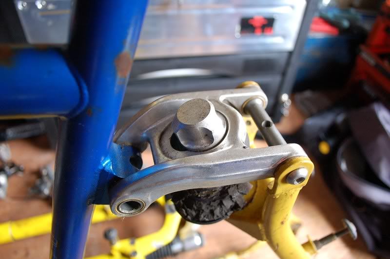

Then it's stripping off the rear frame. Is it a case of slacken/remove the bolts in the pivots and then drifting out the pivot?
How does this top mount for the elastomer come off? should it just screw off? I don't want to chew up the aluminium if I can help it.

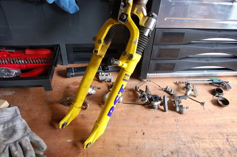

Forks!
Does anyone have an exploded view or strip down guide for RSt 381's please?
Thanks
RST 381's are about as basic as it gets. should just unbolt from the bottom allowing the lowers to pull off with a sharp tug
elastomer stacks unscrew from the top - that's all there will be to these forks
Sawing off the crank arm will be no problem, I've done it several times when renovating old bikes.
I usually cut at 90 degrees to the line in your diagram, as near to the BB axle as possible, cutting in towards the BB, cutting the top of the crank off, and then levering what's left of the crank off. The axle is very hard steel so with just a little care you won't damage it.

Took the forks apart yesterday, and a couple of the elastomers have completly disintegrated.
So unles I can find replacements very cheap, these are scrap too :roll:
It's looking more and more likely that this willl end up just becoming a donor to the build I'm doing for my daughter.
