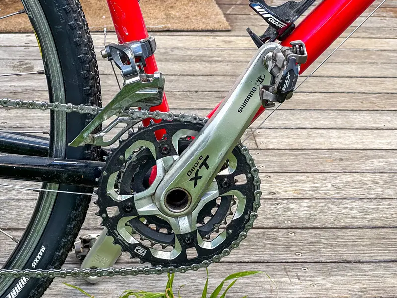

The 10-speed shifter is Shimano 105 from Gumtree; I had the XT chainset and cassette, and the Dura-Ace derailleur already, and a bit of googling confirmed they would work together. I tried the derailleur with a goatlink at first, due to worries that the lowest gear wouldn't work with it, but later took it off again as I have a longer-cage 105 derailleur on the way. And I changed the tyres to Maxxis Rambler EXO.

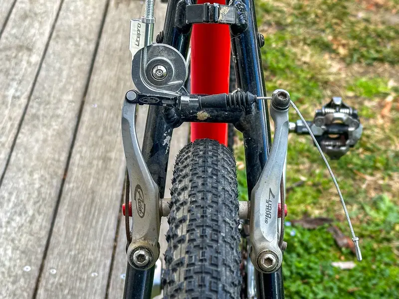

Then I thought I could improve braking by adding V-brakes with Travel Agents, which I did using some nice Avids. All of which mean the original owner wouldn't see much left of his bike except the frame and wheels!

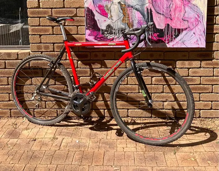

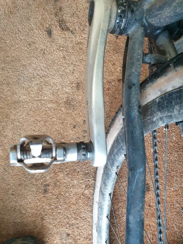

This is how I got it:

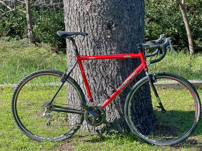

Here it is after changing the brakes, with temporary stem, seatpost and saddle so I could ride it:

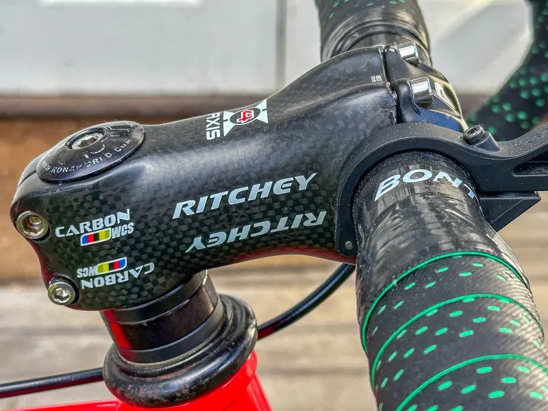

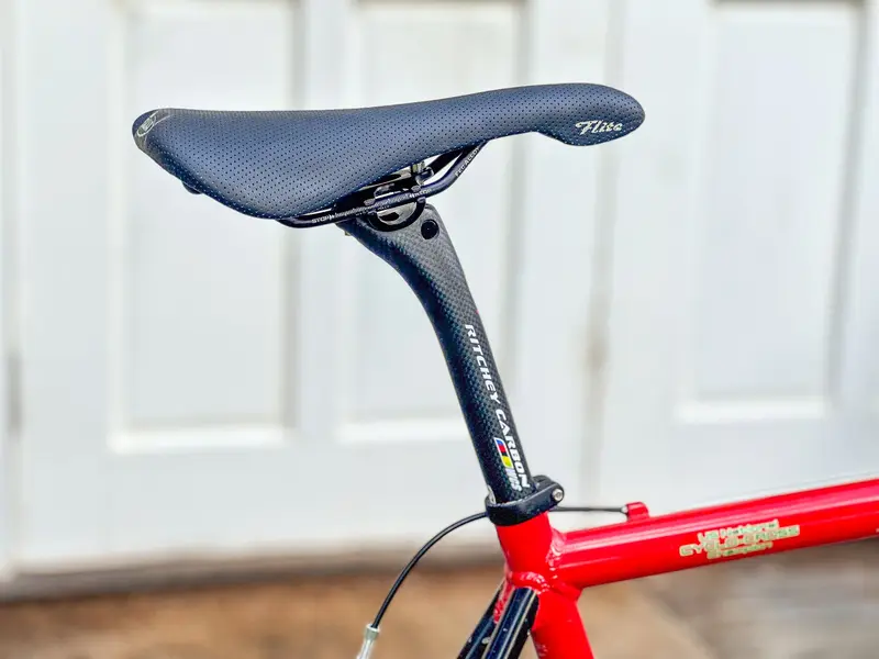

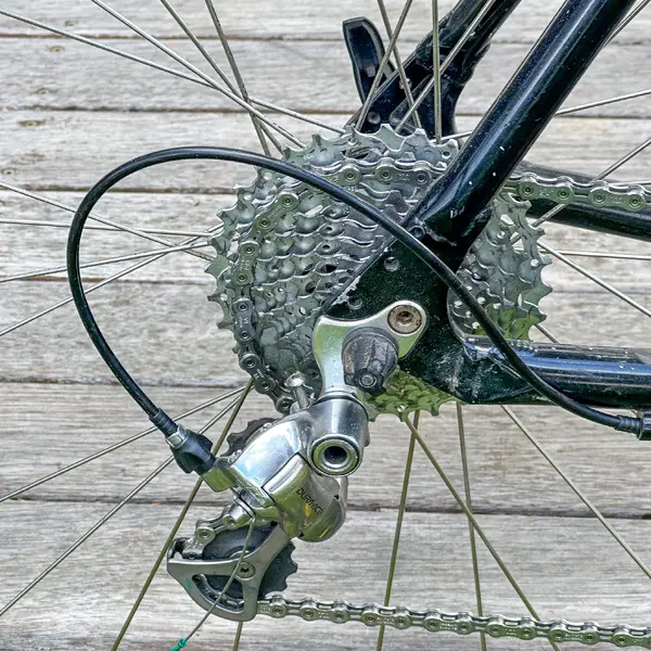

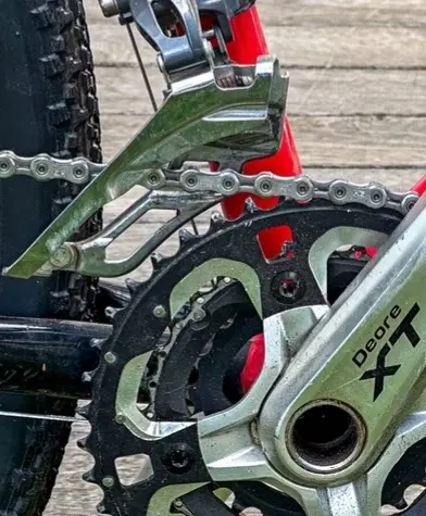

And here are some details of various upgrades described above (and now I want to change the headset too):

And then, after riding it a bit, I decided that it would be much better if it was lighter and smoother with carbon bars and seatpost. And the gaps in the original 8-speed drivechain could be eliminated with an upgrade to 10 speed.
You know how it goes . . . one thing leads to another and what you can't scrounge in the spares box can be found reasonably cheaply online. The stem, for example, although it looks fancy, was $20 because the faceplate was cracked -- and I found a replacement online, also for $20.
