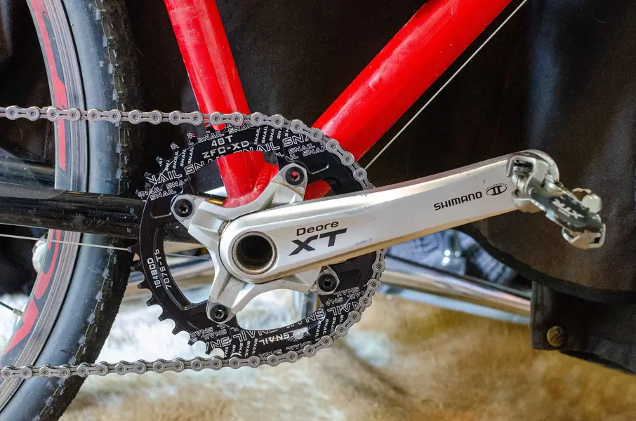

Been through similar with chain-sets.
Found a road triple to be sort of OK, but not really perfect. 130 / 74 BCD felt limiting and the road FDs pretty weak.
Then I tried a compact road double, and got caught up with the fuss trying to get a smaller 110 BCD outer ring. It was better. Think it was a FSA Vero or something like that.
Then went down the MTB hole. I always use square taper, so could actually compress the q-factor and chain-line unlike that more modern XT one - that is probably hardwired with at least a 50mm chain-line, whereas you need something like a 45 - 47mm depending on your rear spacing / hub. Retro MTB cranks are interesting for these builds. I've successfully mated MTB FDs with STIs using an alternative cable pinch position closer to the anchor bolt.
Also tried single up front using cheap out of fashion DH chain rings with the 104 BCD LX M569 (one of the last Shimano square taper with a reasonable Q-factor and chain-line). There's some interesting choices like 36, 38, 40 teeth and they can be flipped for either middle or outer ring position. Personally think the narrow / wide stuff (which I have never used) would be overkill for this. https://www.retrobike.co.uk/threads...n-xt-m739-4-bolt-crankset.415584/post-3138371

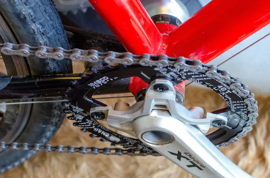

Me likey. Snail/Deckas look fugly but works a treat.Continuing to mess about with this . . . today the budget narrow-wide chainring arrived from China, so spent a bit of time replacing its non-1x predecessor. This took a bit longer than anticipated because the ring is thinner than the previous one, so the longer bolts and spacers I had used didn't tighten fully.
The brand name, 'Snail', while a little uninspiring, does rather reflect my riding pace, so that's all good then.
Also, the instructions on the package, clearly translated from the vernacular via Google Translate, were quite diverting. Here's but a small sample:

Anyway, it's done now, so will be going for another test ride tomorrow. Buckle up!
Meanwhile, I welcome your thoughts on whether it Looks more simple, beautiful and performance coexistence.
