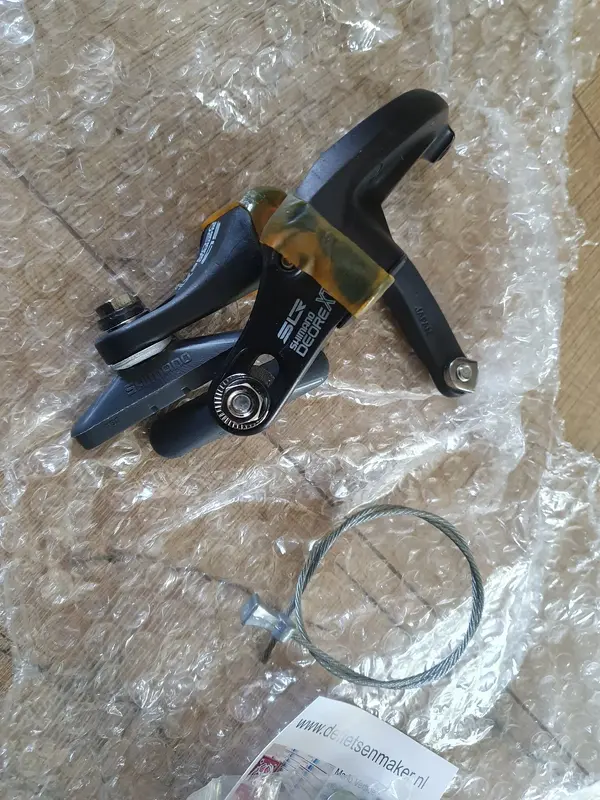

Got these NOS M733 (which were originally specced), hoping to mount them soon.

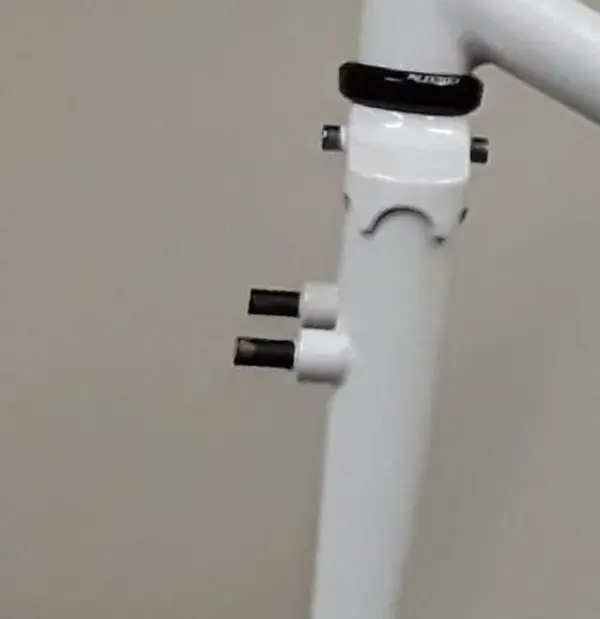

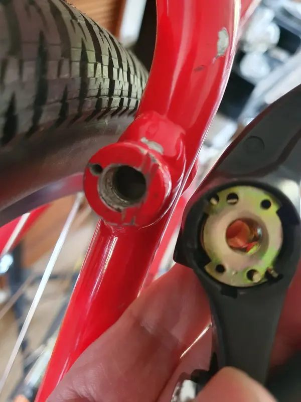

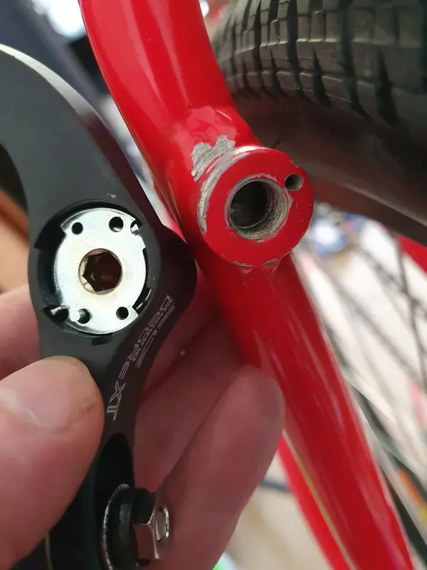

Your missing a bit! You will need some u brake mounts.....fyi, they are different from cantilever mounts......
Im also not sure why your bosses have holes in them? U brakes don't use a spring like a cantilever, its essentially the gripping force of the rear of the brass insert, against the boss that stops the internal spring rotating.....sure they weren't originally roller cam brakes?
I will see if i can get you a measurement and photo...
U brake bosses.....
I cant find the measurement, but, if you get desperate, i can always take one off, but im sure somebody has a frame bare they can measure.
These are originally specced.
Now I don't have the booster which I assume is optional?
And to why this frame has holes in the frame where the bosses go in, I have no idea.
