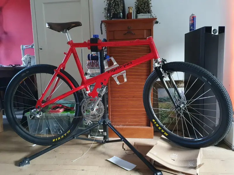

Building the bike nobody wanted. 1991 RidgeRunner.

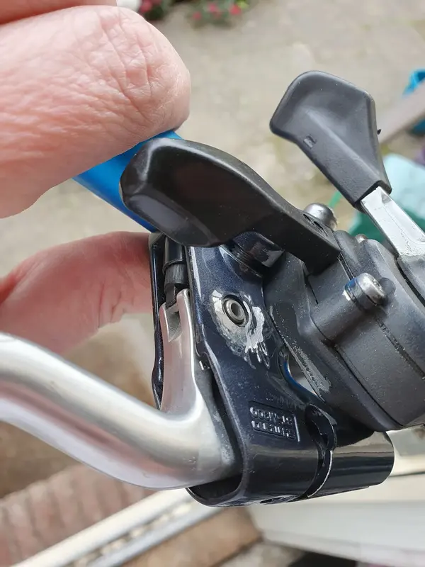

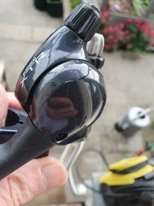

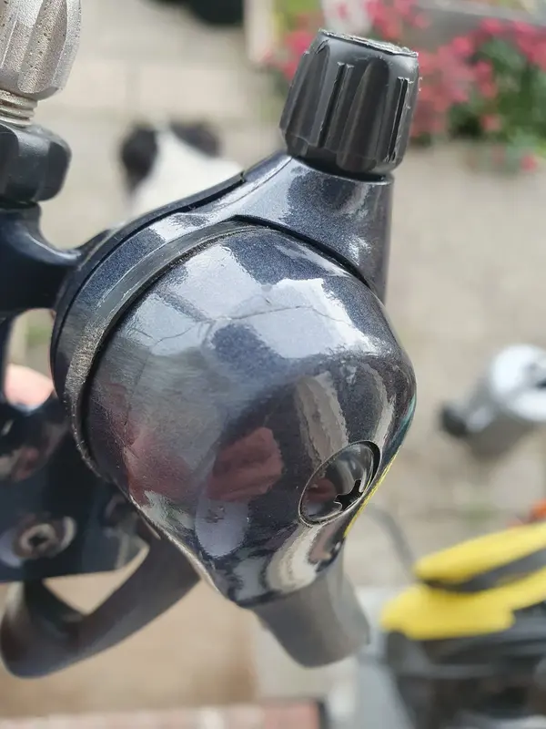

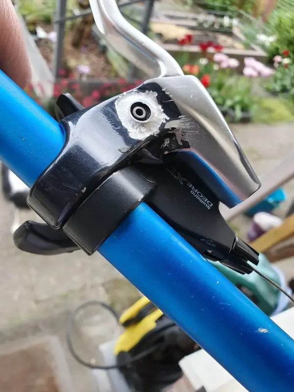

Got these from a bike a bought, the M900 brifters.
Got to clean them today and they are knackered, they are "free" as the bike parts sold for what I payed for the bike.
Someone told me the shifter part was really not very good of these, and I do have a pair of XT 739 shifters in good condition.
Find replacement parts or just chop them into brakes only and sell the shifter hub for parts.
The rest of the bike is M900.

Its not the thread its the boss size. Also there is no step in a u brake boss....see above picture of my white frame compared to the red above....
If your guy with a u brake rear can measure length and width, you know what to get.
The picture from thursday has the bosses for the alloy frame, and indeed it has nostep.
The bolts I got with the NOS set are the same for canti/V brake, 5.5MM so it's something that has no step is x=high and has 5.5MM threading.
Might call Miyata wth I need to get.
