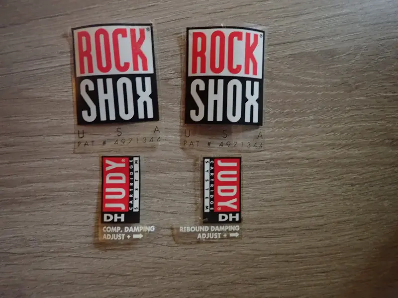

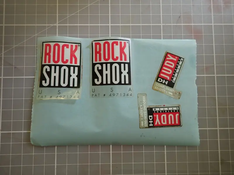

Looking to save the decals. I bought some repros, but they vary quite a lot from the originals. The originals were a bit dog eared with dirt that's worked its way behind them.
You can't beat original so I may as well try saving them.
I cleaned them up with some isopropyl, both sides and took away most of the dirt and old adhesive.

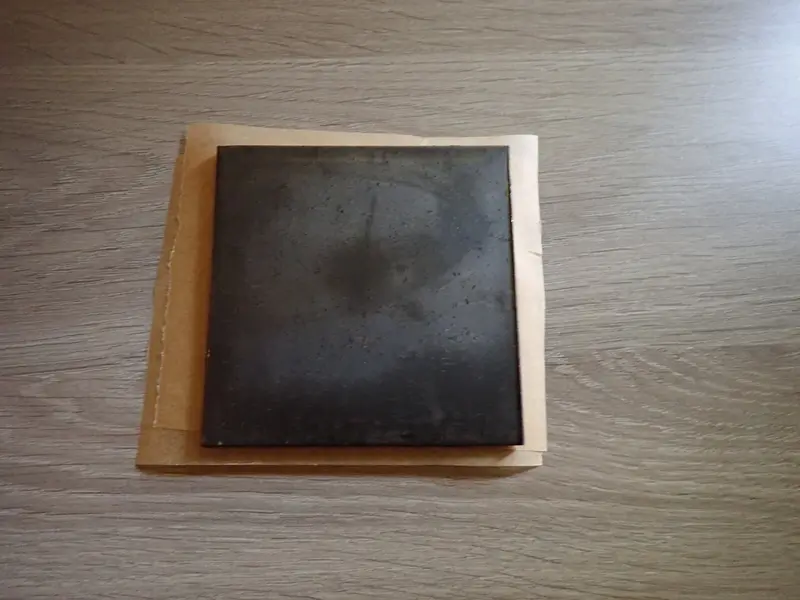

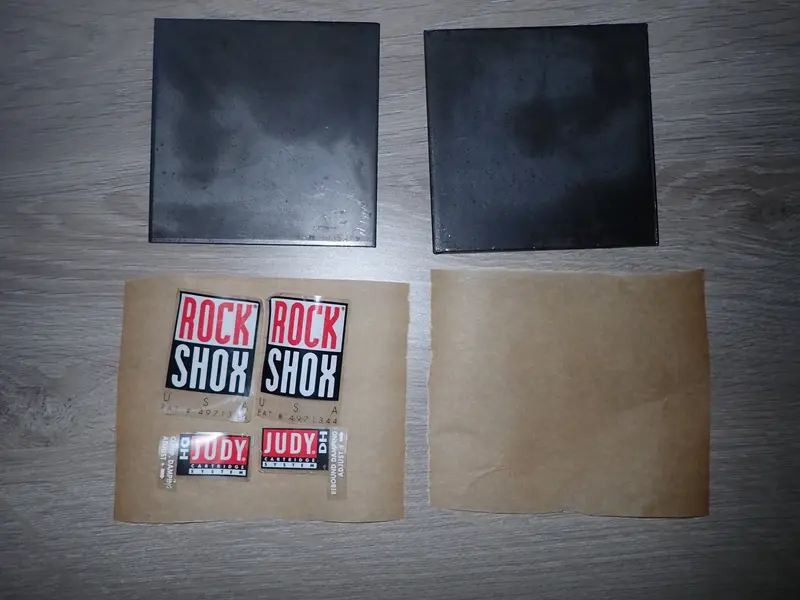

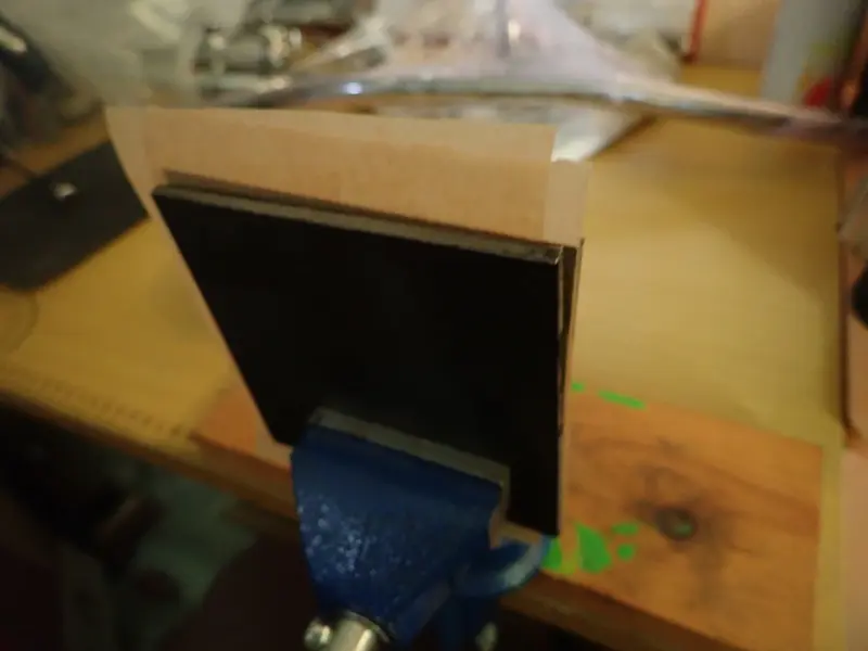

They aren't perfect but they look a lot better, just the dog ear corners and creases to sort out. Enter 2 steel slabs, some baking parchment and a heat gun...
I bought the slabs from a local metal workshop for a couple of quid, the baking parchment should protect the decals while being non stick and heat proof. I'm hoping the heat conducted through the steel softens the vinyl enough to allow the vise and slabs to flatten them out. Right now they're cooling, I'll leave them until cold and see how it went.
Springs aren't affected by temperature and don't eventually crumble to dust or melt into goo. Elastomers are considerably lighter if that bothers you and if you can pick up a few extra harder or softer ones allow more fiddling with the overall spring rate. They both do the job, go with whatever feels right to you. :)
Interested to see what happens with the decals.
Edit: you've saved them nicely! :)
