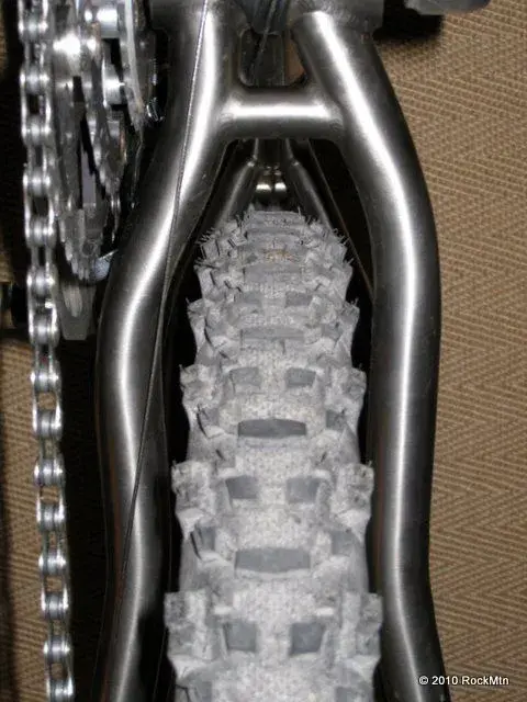

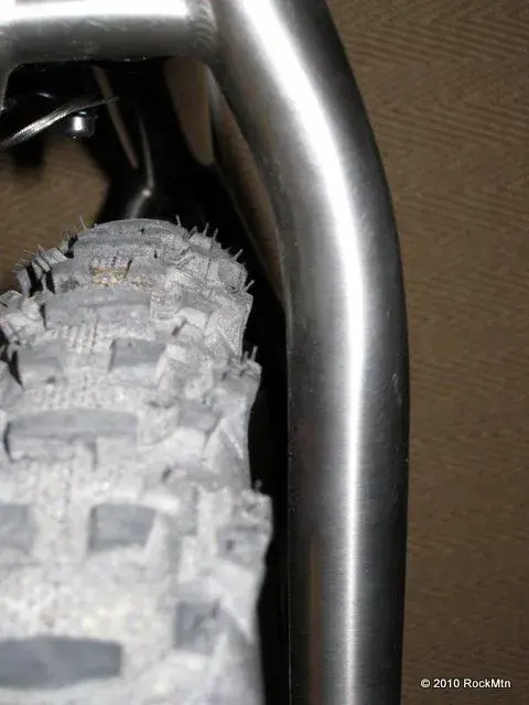

As promised, here are my results…
2.1s SHOULD fit. Tyre is an IRC Mythos, big nobbies on the edges. Plenty of clearance left, right and front. Bit of a hard time getting past the pads on the brakes though.
Mine is a 94 Titanium, not a later XLM, which I think had slightly larger frame tubing? Don't know if the tubing was changed on the stays.
